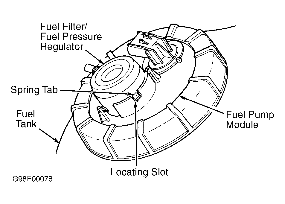

I am trying to locate a fuel filter on a 1998 Chrysler Concorde. I do not see one under the car, is it on top of the fuel tank or in the fuel tank? Do I have to tank the fuel tank out to install it or does it have an access panel in the truck or under the back set?

It is incorporated into fuel regulator and the tank needs to be lowered to replace filter.
Here is guide to help you step by step

Fuel filter is incorparated into pressure regulater, doesnt have a seperate frame mounted filter.

fuel pressure regulater is on top of fuel pump module, fuel tank must be lowered to replace

ok i removed the white clip on the line that goes to fuel tank how do you remove the other end with black clip then my fuel filter will be off

sounds like you got the plastic quick connector off so here is how to remove the metal quick connector, this one requires a special fuel line disconnect tool which your local auto part store should have..
Remove any dirt from the quick-connect fittings.
Wrap shop towels around the hoses to catch any spilt fuel.
At the fuel rail, push the connect fitting toward the fuel tube while depressing the built in disconnect tool with special tool 6751 or equivalent. To disconnect the fitting from the fuel rail, slightly twist the fitting while maintaining downward pressure on the special tool.
Cover the fitting to prevent any contamination.
