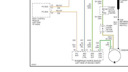

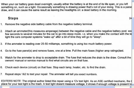

recently my gauges panel had a code NOBU 5 on it but the fuse was good. I then had the battery replaced. The alternator is putting out over 13 volts. But something keeps draining the battery. I was wondering if there was something else that could be draining the battery? I have jumped it and it will only hold a charge for a short time.
May 14, 2008 at 7:38 AM
  • 75,992 POSTS
Could be the body control module or the computer's generator field driver control.
https://images.2carpros.com/forum/automotive_pictures/12900_driver_1.jpg
https://images.2carpros.com/forum/automotive_pictures/12900_parastic_draw_1_3.jpg
