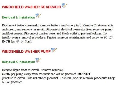

My windshield washer stop working. I unplug the holes with no success so I think its the motor. I found one for 16.99 and want to know if I can put it in, and how.

https://images.2carpros.com/forum/automotive_pictures/261618_Noname_2398.jpg
