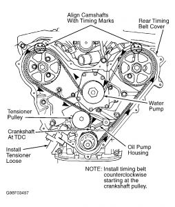

where is the water pump located?

What do u have for engine
need engine size
most likely in with the timing belt
