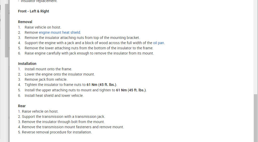

I understand there are three engine mounts, front, passenger and driver side. Just looking for an idea of how difficult the task is to replace one, two or all three.
Thanks for your help.
Oct 31, 2009 at 2:25 AM

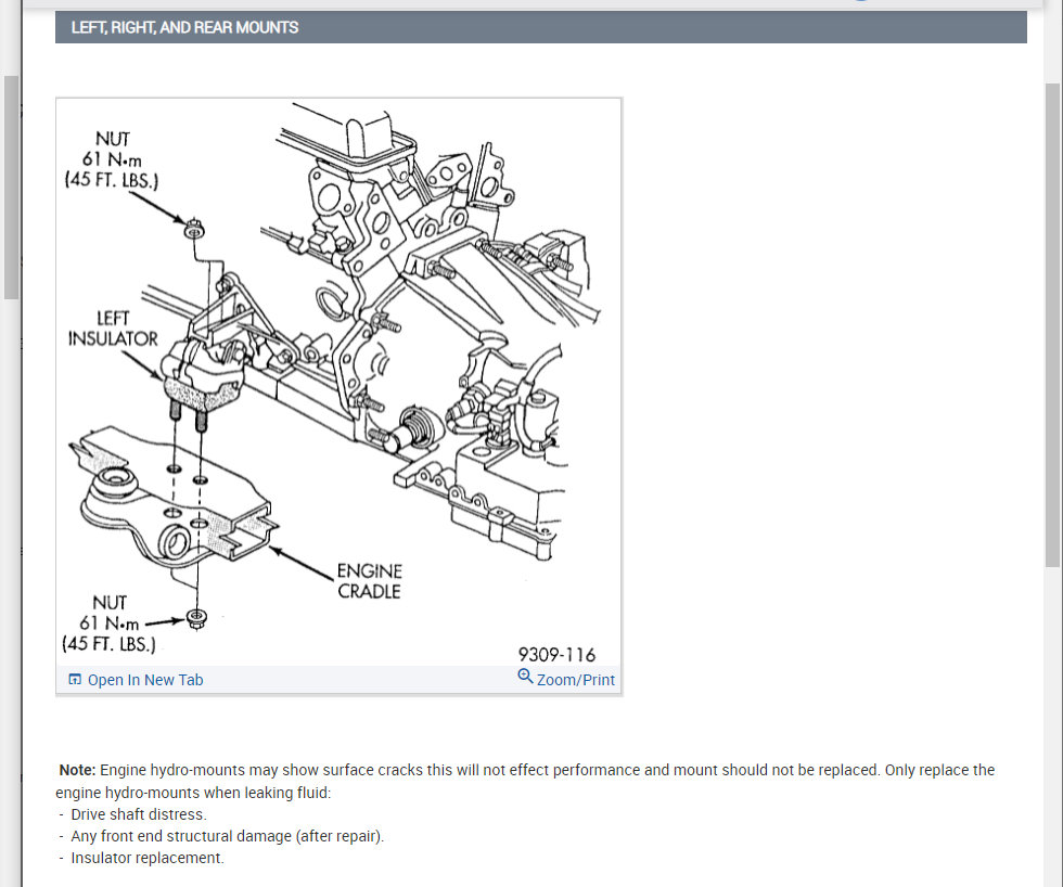

These are not that difficult, you just need some way to support the engine while you are doing one at a time. Most people use a floor jack and blocks of wood to lift one side of the engine at a time.
Here are some guides that will help with this:
https://www.2carpros.com/articles/how-a-motor-mount-works
https://www.2carpros.com/articles/replace-motor-mounts
Below you will find the process from the manual that will give the remaining detail that you may need.
Please run through all this material and let us know if you have other questions. Thanks
