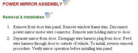

I am trying to replace my driver's side mirror but cannot figure out where the mounting screws are. Can you please help?

https://images.2carpros.com/forum/automotive_pictures/55316_97concordemirror_1.jpg
