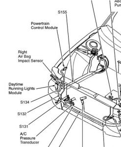

I'm getting a p600 code for my car I can drive fine when I get a few miles it like it idleing high. When I turn the car off it run find for a short time. How can I fix thie problem.

code is P0600

Code P0600 is a CAN bus malfunction, you will need to have the wiring and loom plugs checked for a fault and also the ECU can be faulty, you can have this removed & bench tested.

Where is the EUC located so I can take it out to be tested?

not sure, will have to look that up when i get onto Mitchell 1 later to day. i will post when i find out.

See pic for location of PCM Mark (mhpautos)
