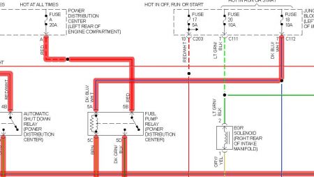

I've been trying to get this concorde started all day. All relays and fuses are good. New fuel pump installed. Still, the fuel pump does not engage, or turn on, when the key is turned. Been checking the wiring. The blue wire connecting to the pump is hot, the dark green/black stripe wire is not. The 2 black wires appear to be grounded fine. On the back of the relay box, the red and 2 blue wires have power, none on the green. Is the green supposed to be ground or power? On the fuse panel box inide the car I have power running thru the fuel pump fuse. Anyway, don't know what else to do to get this fuel pump to turn on. I don't think this car has an inertia fuel cut off, then again if it did the pump should go on for 1 second and it doesn't. Completely stuck here.. Thanks in advance.

Check the fuses and fuel pump relay-The dark green and black wire goes staright to the fuel pump as power input-
https://images.2carpros.com/forum/automotive_pictures/12900_fp1_7.jpg
