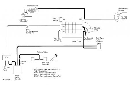

Can anyone forward a vacuum line diagram to me other than the Chilton one.1996 There is a leak and I am not sure all hoses are correct. Its running hard and stalling.
Thank you it is our only car.

https://images.2carpros.com/forum/automotive_pictures/55316_25vacuum_2.jpg
This one is courtesy of Chrysler.
