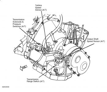

How do you replace this sensor and where is it located.

You will need a Wrench and/or a Deep Well Socket. You can determine size when you purchase the part.
And I would recommend replacing them both they should be less than $35 for both. The Turbine Speed Sensor may also be call an Input Speed Sensor the other will be the Output Speed Sensor.
Below is the locations....

.[/quote:bac649e3c7] Thanks for the diagram. I have already replace the output sensor but did not know where the input sensor was. Once again THANKS ALOT
