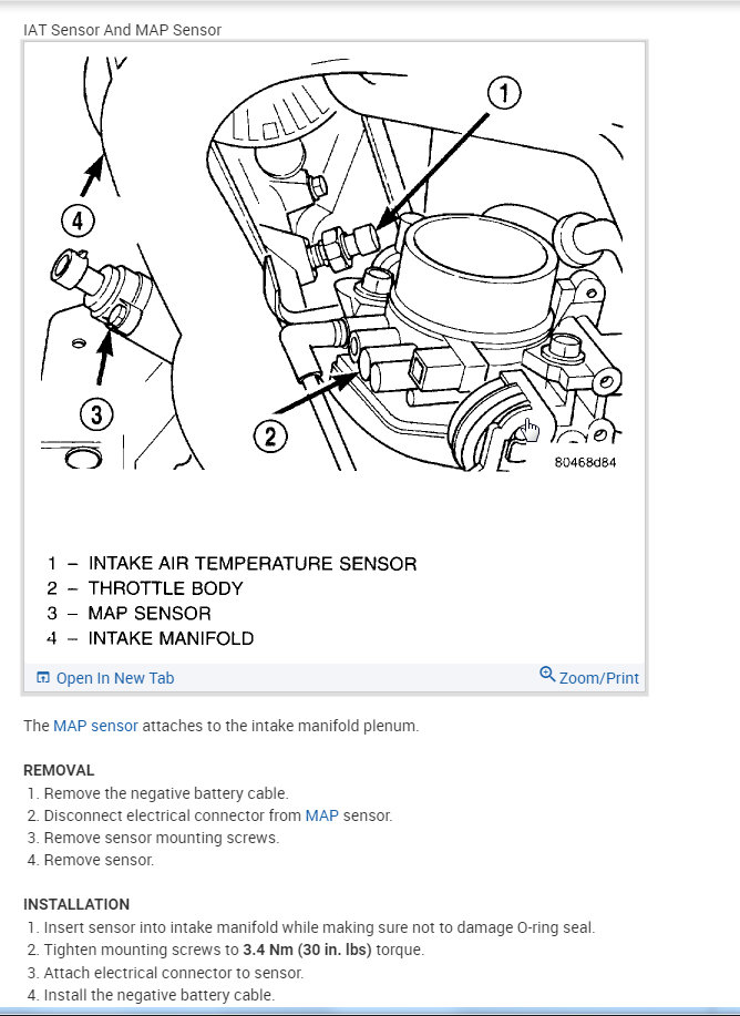

2000 Chrysler Cirrus 2.5 engine does it have a massive air flow sensor and if it does where is it located

Hi Joe,
It does not have an actual mass air flow sensor. The PCM calculates the air flow by using what is called the speed density method. This is engine speed, manifold pressure, and air temp to determine how much air is coming into the engine.
