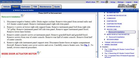

How do you replace a heater core on a 1997 Chrysler Cirrus

I have changed the thermostat and am now looking to replace the heater core, my question is, how do you replace the heater core on this 1997 Chrysler Cirrus?

I was double checking if it was the thermostat or clogged heater core that's causing it not to produce heat. Replacing the heater core either its leaking or it clogged-up-nothing was mentioned on it-Sorry Heater core removal
https://images.2carpros.com/forum/automotive_pictures/12900_heater_core_5.jpg
