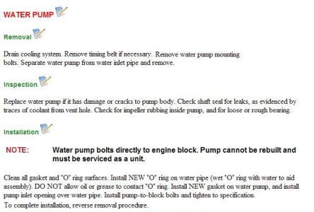

procedure to change water pump? Step by step please!

https://images.2carpros.com/forum/automotive_pictures/261618_Noname_1308.jpg
