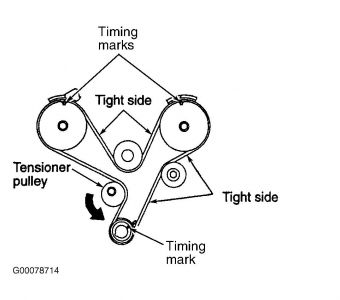

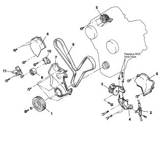

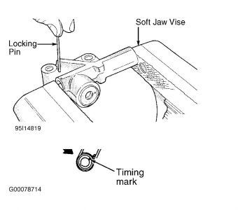

to remove the harmonic balancer it is necessary to remove the 22mm bolt on the end of the crankshaft.This bolt does not want to come out. Is it right or left handed thread? Bob
Apr 30, 2008 at 4:34 PM
BMRFIXIT
  • 19,053 POSTS
1. you need to remove center bolt in the middle of the crankshaft pulley 2. it left to loosen check the pictures
