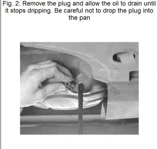

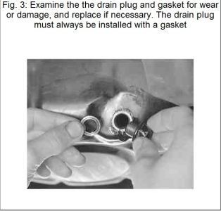

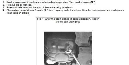

Hi, How am I gng to change my engine oil with a new one, it`s due for replacement,pls do i nd to replace the fuel filter along wit it.

If you change the oil, change oil filter also. Changing the fuel filter is fine, just make sure there is pressure on fuel system before taking any lines loose. When adding oil, check the dipstick, so you don't overfill. I don't have the crank case capacity in front of me, so check the crankcase dipstick for the full mark, after letting engine run, check the dipstick again after it settles, engine off. I can't see what your doing from here, so doing everything correctly is your responsibility. After the procedure, check for leaks.
