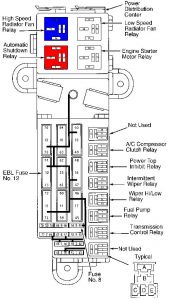

1998 chrysler wont turn over to start,but it wants to start,all ready replaced fuel filter and fuel pump,still wont start.i need to know when you put the gas on it stoll out?

ASD relay should be the first thing to check. Inside the fuse box under the hood, try switching the two highlighted relays. See what happens.
