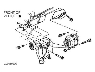

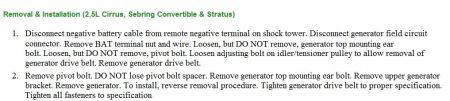

how do i install an alternator and pulley?

how do i remove the belt to replace the belt that goes to the alternator?

you can go through the right front wheel well if you remove wheel and fender lining. loosen the PS pump bolt 2 turns or so then loose the adjusting bolt on the PS bracket (should have curved slot). Remove the PS belt. Loose the idle bolt on the idler pulley (between alternator on top and AC compressor on bottom). Loosen the bolt in the middle of pulley. Slide the pulley toward front of vehicle and belt should come off.
