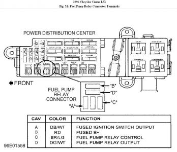

So the main issue you are having seems to be with it acting sluggish, no power and intermittent stalling, correct? The first thing I see is that you never mentioned that the air intake was fixed. If there is a leak in the air intake system then it can cause a lot of issues, including the symptoms you describe. The engine needs a certain combination of fuel and air to run properly. With this leak, it is not getting the air it needs and will run poorly. I would also assume that is the reason the mass airflow (MAF) sensor code came up on the scanner. Anytime there is a leak in the intake system the MAF sensor code usually appears as a result.

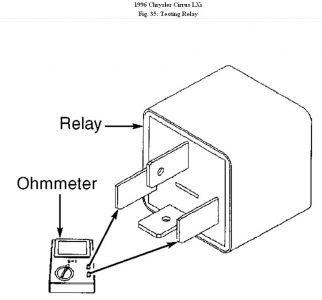

For the coolant to be bubbling out to the recovery tank without signs of overheating, the likely cause would be a bad radiator cap.
DTC P1768 = Code 15 for 2 digit codes. Here are the diagnostic procedures.
TEST 15: RELAY OUTPUT ALWAYS OFF
1. Turn ignition on. Disconnect transmission control relay. Measure voltage between ground and fused B+ (battery positive) circuit in relay connector. If voltage is greater than 10 volts, go to next step. If voltage is not as specified, repair open in fused B+ (battery positive) circuit.
2. Turn ignition off. Measure resistance between chassis ground and ground circuit in relay connector. If resistance is less than 5 ohms, go to next step. If resistance is not as specified, repair open in transmission control relay ground circuit.
3. Turn ignition on. Connect a fused jumper wire between fused B+ (battery positive) circuit and transmission control relay output circuit in relay connector. Using scan tool, observe switched battery voltage. If voltage is greater than 10 volts, go to next step. If voltage is not as specified, go to step (7).
4. Remove jumper wire. Turn ignition off. Disconnect TCM harness connector. Measure resistance between ground and transmission control relay control circuit at TCM harness connector. If resistance is less than 5 ohms, repair transmission control relay control circuit for a short to ground. If resistance is not as specified, go to next step.
5. Measure resistance of transmission control relay control circuit between TCM harness connector and relay connector. If resistance is less than 5 ohms, go to next step. If resistance is not as specified, repair open in transmission control relay control circuit.
6. Reconnect transmission control relay. Connect a fused jumper wire between battery voltage and transmission control relay control circuit at TCM harness connector. Measure voltage between ground and transmission control relay output circuit at TCM harness connector. If voltage is greater than 3 volts, replace TCM. If voltage is not as specified, replace transmission control relay.
7. Turn ignition off. Disconnect TCM harness connector. Ensure fused jumper wire is still connected between fused B+ (battery positive) circuit and transmission control relay output circuit in relay connector. Turn ignition on. Measure voltage between ground and both transmission control relay output circuits. If voltage is greater than 10 volts at one or both terminals, replace TCM. If voltage is not as specified, repair open in appropriate transmission control relay output circuit.

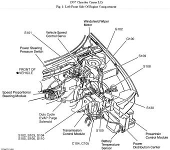

Okay, my neighbor says that none of this should be a problem to check. Only we don't exactly know where or what exactly we are looking for. We tried to look the TCM up on a parts site but could not find it.
Also, we are aware that there are two speed sensors and are wondering if it is possible that maybe it could have something to do with the speed input sensor; since we have already replaced the output sensor. We found that part so we know what it looks like, just don't know where to find it in the car.
So if you could let us know where the TCM is, and whether or not we should bother with the other speed sensor. If we should replace the other speed sensor we would need to know where that is as well. Thank you very much for your time.

I found a picture of the TCM and I am pretty sure it is the computer under the hood. The ABS controller is clearly marked so I am pretty sure it is the one that I added a ground to.
We are going to go ahead and go through the steps, hoping that we don't have to replace the TCM. From what I can see it would run from $100-$300, which is getting pretty pricey after all of the rest we have done. Hopefully it is just the ground or relay.

Here is a diagram of the TCM location.
https://images.2carpros.com/forum/automotive_pictures/192750_EngineComp97CirrusFig01_1.jpg
Good luck.

It was the relay. Wow, thank goodness. That was one of the first places we looked and it was fine. I don't know but I really appreciate the help. It is running great now, like new. Hoping to sell it and make some money out of it from all that we have done.

Symptoms indicates it is related to the fuel pump so we can forgo the others for now. We need to get the fue pressure up first. CHECKING FUEL PUMP 1.Turn ignition off. Disconnect fuel pump relay. For fuel pump relay location, See Fig. 51. Using scan tool in voltmeter mode, check voltage on fuel pump relay connector fused ignition switch output circuit. See Fig. 35. If voltage is more than 10 volts, go to next step. If voltage is 10 volts or less, repair open fused ignition switch output circuit. 2.Install a substitute relay. Attempt to start engine. If engine does not start, go to next step. If engine started, replace fuel pump relay. 3.Reinstall original fuel pump relay. Disconnect fuel pump harness connector, Inside Trunk On Left Side, Near Base Of Shock Tower. Turn ignition on. Using scan tool, actuate ASD fuel system. Using scan tool in voltmeter mode, check voltage of fuel pump relay output circuit at fuel pump connector (harness side). If voltage is more than 10 volts, go to next step. If voltage is 10 volts or less, repair open fuel pump relay output circuit. 4.Turn ignition off. Using scan tool in ohmmeter mode, check resistance of fuel pump ground circuit at fuel pump connector (harness side) Black/Light Green wire. If resistance is less than 5 ohms, replace fuel pump. If resistance is 5 ohms or more, repair open fuel pump ground circuit.
https://images.2carpros.com/forum/automotive_pictures/192750_FuelPumpRelay96CirrusFig35_1.jpg
https://images.2carpros.com/forum/automotive_pictures/192750_FuelPumpRelay96CirrusFig51_1.jpg

Checked all of that. The last step was the one step that went wrong. At the wire harness the ground was between 6 and 7. We are not sure how to fix this.
While we checked that we took a look at some other things as well. First off we tried to get the car to turn over, unlike before it wouldn't turn over at all. We then decided to check the gas pressure. This time it actually seemed to have plenty of pressure in the line. We wondered if maybe it was the injectors, so we put the meter on the ones we could get to. They seem to be working. When we turned the key we could hear the fuel pump turning on faintly.
Don't really get why it won't turn over at all today. Would think it would continue to do the same thing as before. ????FRUSTRATING!!!!!!!!
