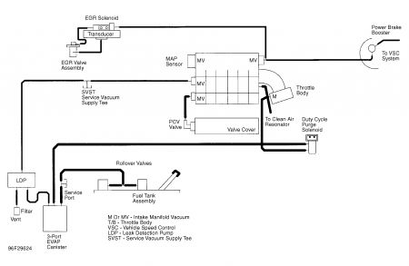

Engine Mechanical problem
1996 Chrysler Cirrus 6 cyl Front Wheel Drive 140000 miles
Where does the hose from the EGR tranducer solenoid attach to at the motor? I ltook it off after a tune up and can not find where the elbow fitting attaches. I have the manual and I have accounted for all other lines. The line from the brake booster is attached already.

https://images.2carpros.com/forum/automotive_pictures/99387_Graphic1_75.jpg
