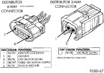

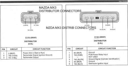

my car is a 1996 chrysler cirrus , 2.5 engine ,..i've read about many cases on mazda forums about modifications on ignition systems ,these cars have similar distributors ,but connectors have some differences,on that forums bassically they use 4 pin GM HEI modules using distributor's internal coil or using external coils ,i want to know how can i make the same modification to my cirrus,maybe you can get me a diagranm or something else ... thanks
p.d.:i send you one picture with both connectors(cirrus and mazda)

[img:9a26d6d8f5]http://www.2carpros.com/forum/automotive_pictures/552194_conector_dist_cirrus_doble_1.jpg[/img:9a26d6d8f5]
[img:9a26d6d8f5]http://www.2carpros.com/forum/automotive_pictures/552194_conexiones_distrib_mx6_2.jpg[/img:9a26d6d8f5]

We have no information on this modification on our data base, and personally i have no experience with this modification, i did have a bit of a look around a few sites but nothing jumped pout as being of much use, this question is still open for others to respond to, but in the meantime i will look into it a bit further and let you know if i find anything that will be of help.
