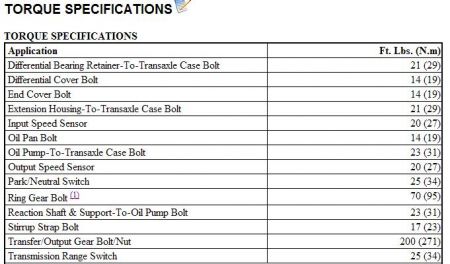

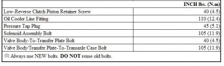

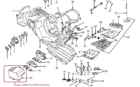

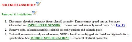

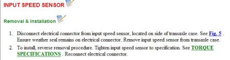

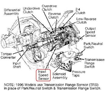

I just purchased a transmission solenoid shifter and want to know how to install it. I want to know whether I must empty the transmission of the fluid. I just replaced with a new filter thanks

FIGURE 13

FIGURE 5

Hope this helps.. Thanks for using 2CarPros.com!
