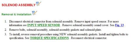

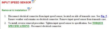

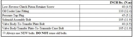

I just purchased a transmission solenoid shifter and want to know how to install it. I want to know whether I must empty the transmission of the fluid. I just replaced with a new filter thanks

https://images.2carpros.com/forum/automotive_pictures/261618_Noname_148.jpg
https://images.2carpros.com/forum/automotive_pictures/261618_Noname2_52.jpg
FIGURE 13
https://images.2carpros.com/forum/automotive_pictures/261618_Noname3_23.jpg
FIGURE 5
https://images.2carpros.com/forum/automotive_pictures/261618_Noname6_3.jpg
https://images.2carpros.com/forum/automotive_pictures/261618_Noname4_13.jpg
https://images.2carpros.com/forum/automotive_pictures/261618_Noname5_7.jpg
Hope this helps.. Thanks for using 2CarPros.com!
