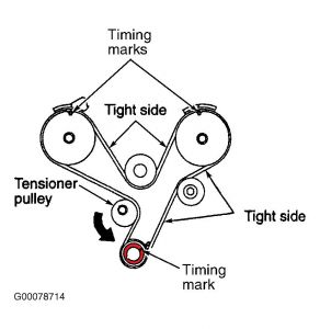

just changed water pump pulled timing belt tensioer complety off now engine will rotate and stop and act like it locks up is there something that i did wrong for it to do that

recheck timing belt marks and set
https://images.2carpros.com/forum/automotive_pictures/99387_chry_sea_2.jpg
