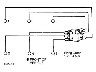

what is the firing order for this 2.6 v6 engine?

You mean the 2.5L?
