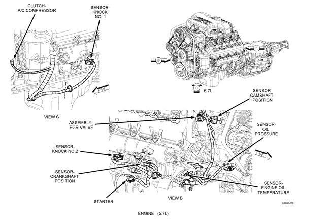

the oil pressure light comes on intermittently. I have changed the oil and filter, replaced oil pressure sensor and problem with oil pressure is still occuring?

I would change out the oil pressure sender first. Here is the location. Check out the diagrams (Below). Please let us know if you need anything else to get the problem fixed.

I had this problem and had to have the oil pan removed and the oil pump pic up screen cleaned FYI,
