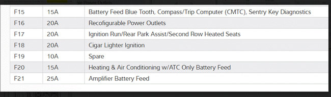

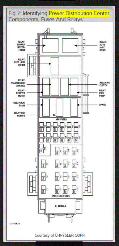

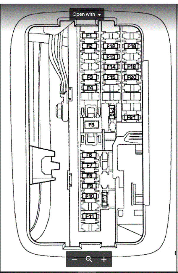

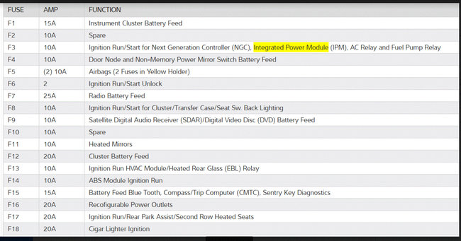

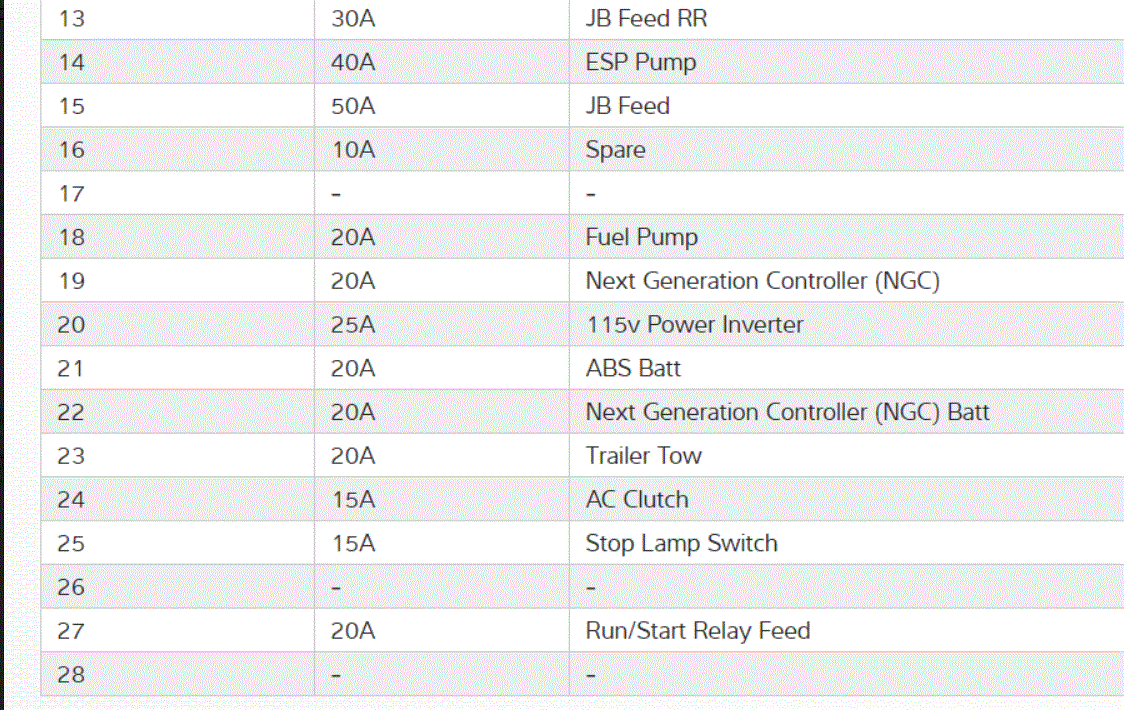

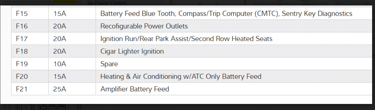

Where is the heated seat control fuses and how do I check them?
Dec 10, 2008 at 9:02 AM
  • 110,244 POSTS
If you look at the attachments below, they provide the fuse box orientations and what each fuse is for.
In addition to just checking a fuse, make sure there is power to it. A fuse may be good and not be receiving power.
Here is a link that you may find helpful when testing:
I hope this helps. Let me know if you have additional questions.
