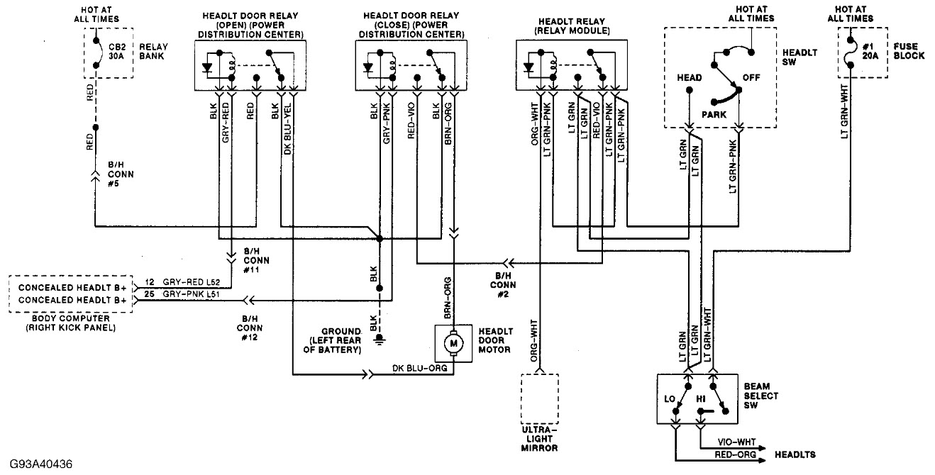

Headlight doors do not close

Mine will not come on at all.

I'm sending teh schematic for auto headlight doors, check the close relay in the power dist
Image (Click to make bigger)
