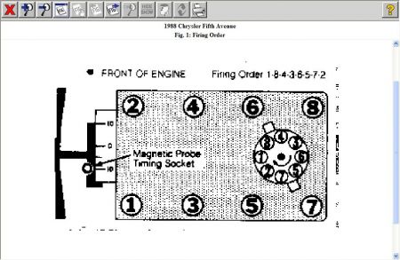

1988 Chrysler 5th Avenue firing order of sparks plugs
1988 CHRYSLER FIFTH AVENUE
PATTY CARD
Engine Performance problem
1988 Chrysler 5th Avenue V8 Two Wheel Drive Automatic
car is back firing in carb when driving
May 5, 2008 at 7:27 AM
  • 75,992 POSTS
https://images.2carpros.com/forum/automotive_pictures/12900_fo_5_1.jpg
Backfiring: check the ignition timing/fuel pressure and accelerator pump
