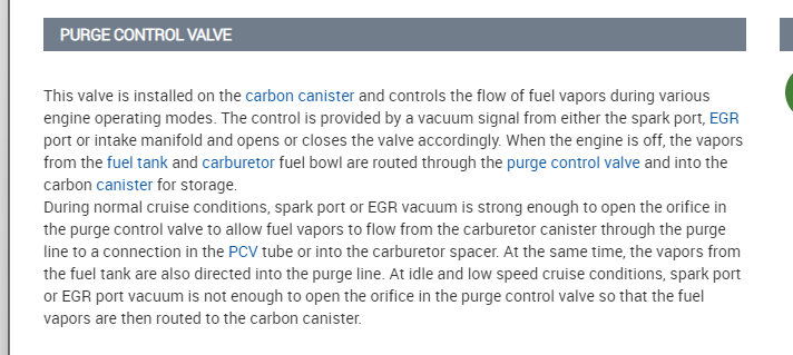

More than likely you still have a vacuum leak. So that means we need to start with using this guide to find where that leak is.
If there is no vacuum leak, then we need to inspect the purge system. If you have a stuck purge control valve, then this can cause the engine to run rich and will throw off the RPM as there is rich fuel vapor coming in when it should not.
I am attaching the info below on this for your review.
Please run through this info and let me know what questions you have.
Thanks
