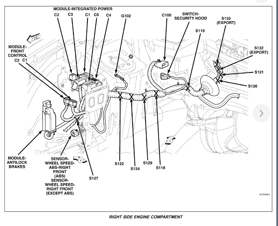

Windshield wipers, high beam lights, blinkers, the front windows, seat heaters, both car charger ports, and radio do not work suddenly after mechanic replaced fuel pump for a bad wire. The radio lights up but nothing will play or come on screen.

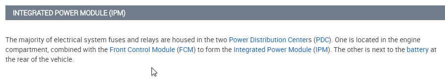

Clearly this doesn't make much sense because these are not related outside of the integrated power module. So the wire issues is what I am wondering why the fuel pump needed to be replaced because of a wiring issue. Did something happen that cause the wire issue? Was this hit by lightening or something drastic like that?

I replaced a 30 a pink fuse in the back for the consul power that fixed most of the problems apart from the radio. When I tried to replace the light blue 20 amp fuse for the sound it immediately blows. I have no idea why as I have very little knowledge of cars. :/

Okay. That means you have a short in that circuit. You need to test it for a short to power and ground.
Can you get a picture of the fuse location so I can try to get you a wiring diagram of that circuit?
