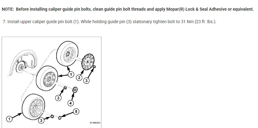

When stopped on an incline my car will drift backward while in drive if I release the brake I can hear the rear brakes grinding I think I need brakes.

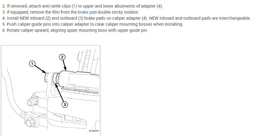

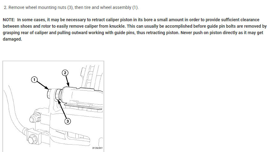

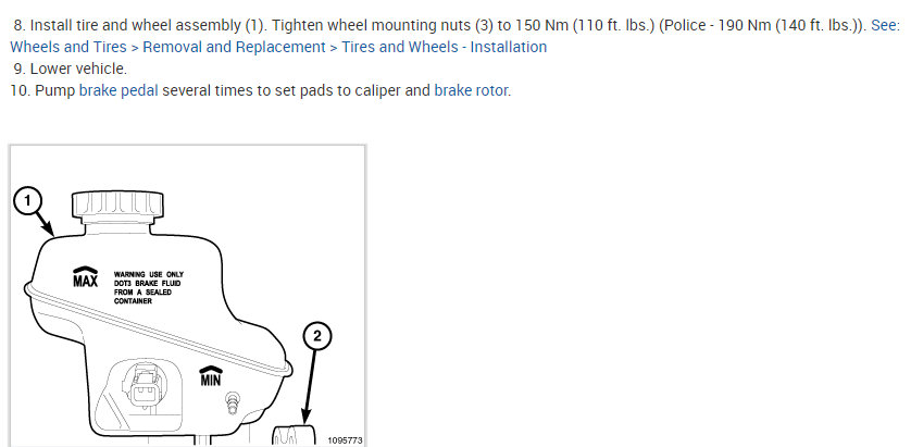

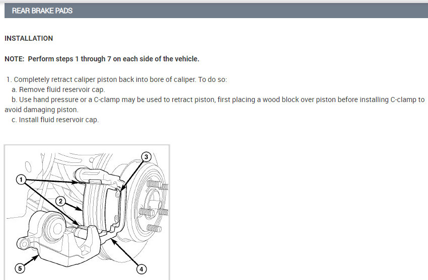

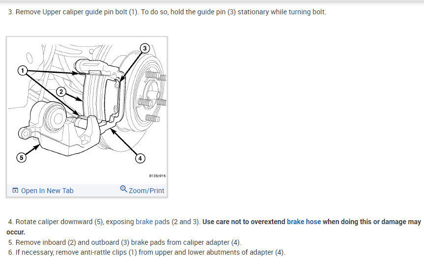

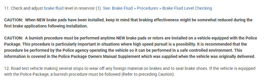

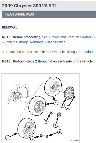

Here is the information you requested. Here is a tutorial on how to remove and replace rear brake pads and rotors:
https://www.2carpros.com/articles/how-to-replace-rear-brake-pads-and-rotors
Here is a YouTube video from our site on how to compress the rear caliper piston when performing a rear brake job:
https://youtu.be/j8YwfSKEzZo
I've attached picture steps below on how to replace the brake pads and rotors on your vehicle. Hope this helps and thanks for using 2CarPros.
