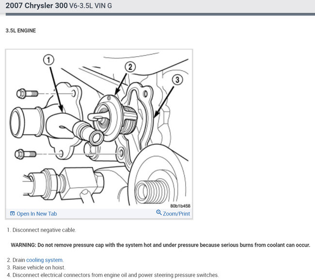

Does a Chrysler 300 V6 3.5 engine have thermostat if so where is it located?
Monday, January 4th, 2010 AT 6:26 PM
6 Replies
BLUELIGHTNIN6
  • 16,542 POSTS
The engine cooling thermostat is located at the bottom of the engine by the oil filter here is a guide that will walk you through the repair with diagrams below to show you how on your car.

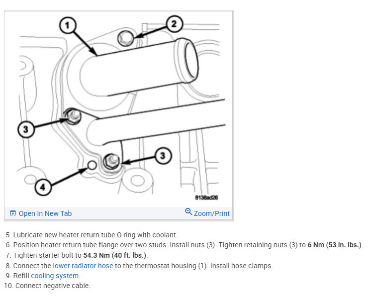

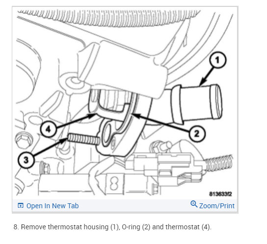

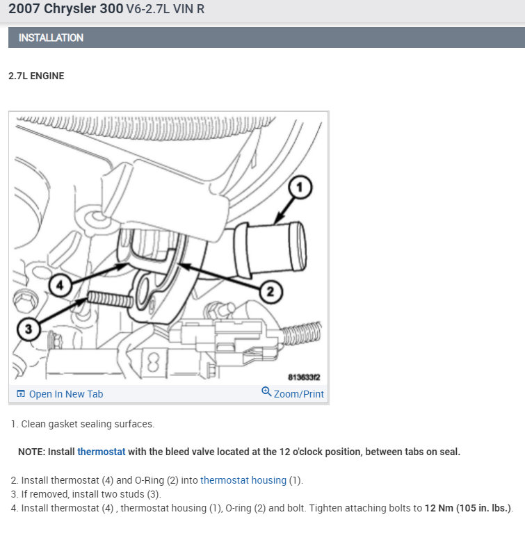

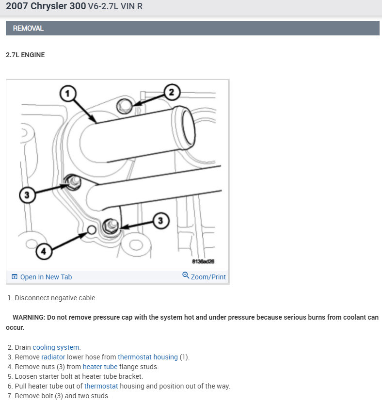

Can you tell me where I can find the thermostat? My car is a 2.7 Liter engine. Maybe if you can also send me a diagram. Please.
Monday, July 29th, 2019 AT 7:24 PM (Merged)
  • 52,797 POSTS
Disconnect negative cable.
WARNING: Do not remove pressure cap with the system hot and under pressure because serious burns from coolant can occur.
2. Drain cooling system.
3. Remove radiator lower hose from thermostat housing (1).
4. Remove nuts (3) from heater tube flange studs.
5. Loosen starter bolt at heater tube bracket.
6. Pull heater tube out of thermostat housing and position out of the way.
7. Remove bolt (3) and two studs.
8. Remove thermostat housing (1), O-ring (2) and thermostat (4).
-1
SQM
  • 6,383 POSTS
Just follow the lower radiator hose from the radiator to the engine. The hose goes into the thermostat housing.
Simply remove the hose then take off the mounting bolts on the housing to access the thermostat.
I have attached diagrams for the thermostat replacement procedure below.
