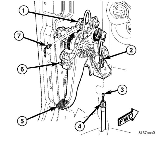

My parking brake is on and the release handle broke. Is there a way to release the park brake without the release handle?

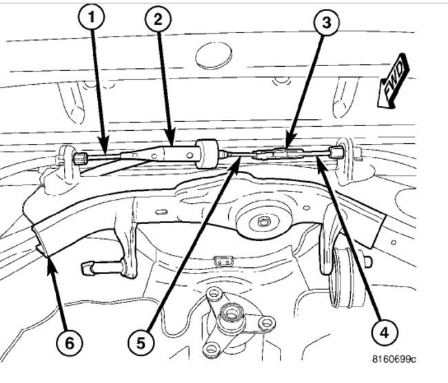

Not without cutting the parking brake cables it best to get it released. Here is a guide (below) on how to fix the problem. You can release the lever by activating the release on the mechanism. You can do this by pulling on #4 in the diagrams below.
Raise and support vehicle.
NOTE: Due to short travel and low spring tension, it is not necessary to lock-out parking brake lever to service parking brake components.
Disconnect front parking brake cable (5) at connector (3) to right rear parking brake cable.

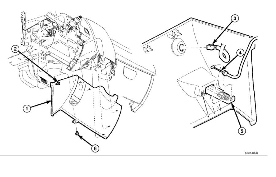

Remove fasteners (6) securing steering column opening cover (1) in place.
Disconnect wiring connector (3) at decklid release switch.
Disconnect parking brake release cable (4) at lever (5) and remove steering column opening cover (1).
Disconnect wiring connector (7) at parking brake switch (1).
Disconnect front parking brake cable strand (3) at lever connector (2).

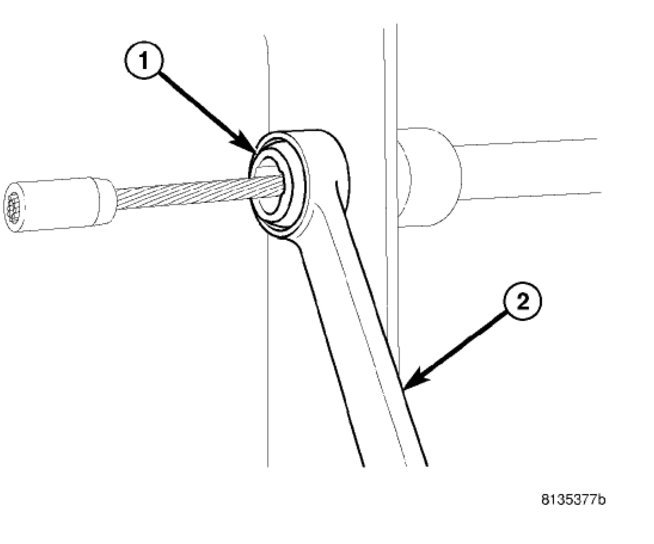

Place 13 mm 12-point box wrench (2) over cable retainer (1) at lever bracket as shown to collapse retainer fingers. Pull cable from bracket.
Remove bolt (4) and two nuts (2) mounting parking brake lever (3) to body (5).
Remove parking brake lever (3).
