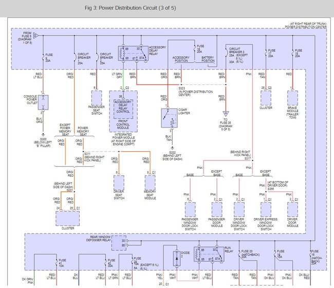

Hello and thank you, i love this site.

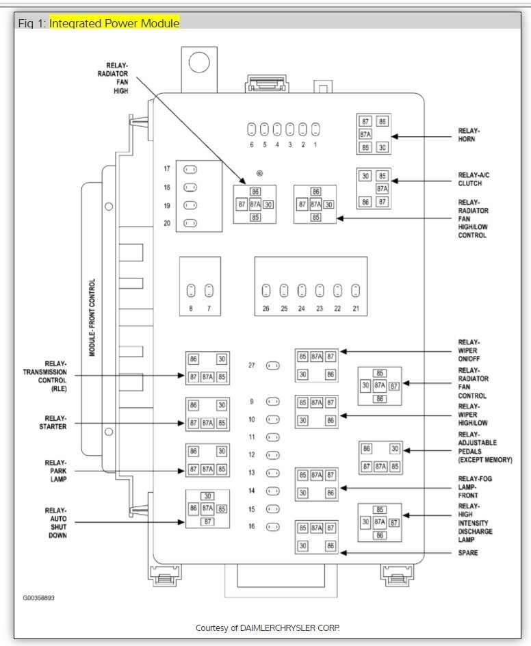

There is no power coming from the Cigarette Lighter (Power Outlet as listed in the manual). I have searched both fuse boxes of the vehicle and can not locate the appropriate fuse or type to replace.
The selection in the manual does not have a listing for the Power Outlet or for which fuse to replace.
Originally, a penny got caught in the Cigarette Lighter. I would love to be able to have a place to charge my phone while in the vehicle.
Thanks.
Mike
Mar 29, 2010 at 6:54 PM
  • 55,658 POSTS

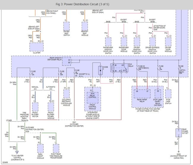

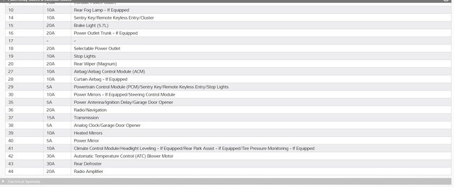

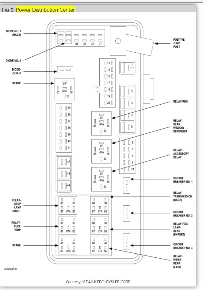

It is fuse #18 the selective power fuse. Here is a guide and some diagrams (below) that will help you get the problem fixed.
and

Re 2006 Chryster 300, 6 cylinder, 3TR, Where are the fuses for the cigarette lighter and is it one fuse or shared with another item i.e., horn, etc.?
Jul 10, 2017 at 9:22 AM (Merged)
HMAC300
  • 48,601 POSTS
the fuse in the right rear trunk power dist box
