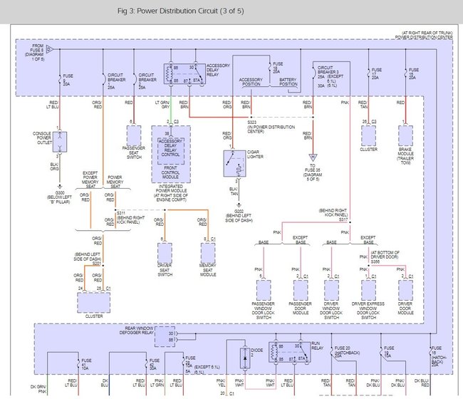

There is no power coming from the Cigarette Lighter (Power Outlet as listed in the manual). I have searched both fuse boxes of the vehicle and can not locate the appropriate fuse or type to replace.
The selection in the manual does not have a listing for the Power Outlet or for which fuse to replace.
Originally, a penny got caught in the Cigarette Lighter. I would love to be able to have a place to charge my phone while in the vehicle.

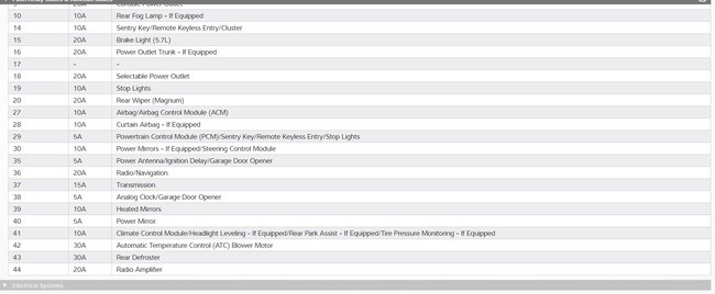

It is fuse #18 the selective power fuse. Here is a guide and some diagrams (below) that will help you get the problem fixed.

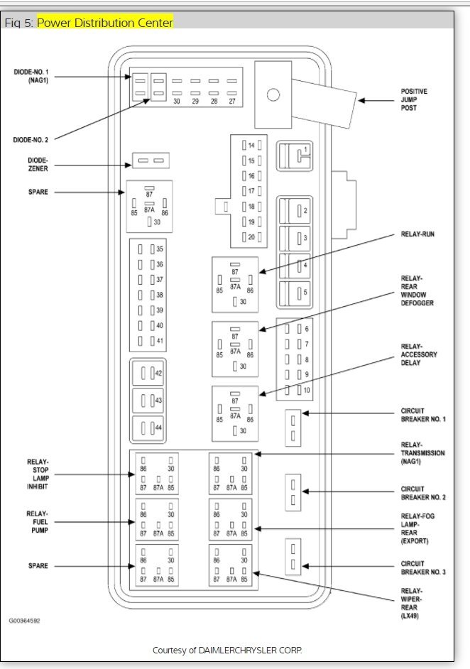

The fuse in the right rear trunk power dist box
