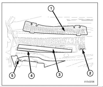

Remove the air inlet grille (1) from the wiper module screen (2) located near the dash panel in the engine compartment. Open the filter door (3) on the top of the particulate air filter housing (4) located inside of the dash panel plenum (5). NOTE: To aid in reinstallation, note the installed position of the particulate air filter prior to removal of the filter.

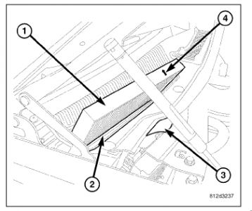

Remove the particulate air filter (1) from the particulate air filter housing (2) located inside of the dash panel plenum (3). Note the direction of air flow indicated by an arrow (4) on the filter. INSTALLATION NOTE: The particulate air filter is labeled with "REAR OF VEHICLE" and an arrow to indicate air flow direction through the filter. Make sure to properly install the particulate air filter. Failure to properly install the filter will result in the need to replace the filter sooner than required by design. LHD model shown in illustrations. RHD model similar.
https://images.2carpros.com/forum/automotive_pictures/12900_c2_43.jpg
Install the particulate air filter (1) into the particulate air filter housing (2) located inside of the dash panel plenum (3). Insert the particulate air filter down directly into the filter housing with the arrow (4) on the filter pointing to the rear of the vehicle. The particulate air filter is held in place by friction between the filter element and the filter housing, so no fasteners are required.

Close the filter door (3) on the top of the particulate air filter housing (4) located inside of the dash panel plenum (5). Install the air inlet grille (1) onto the wiper module screen (2). https://www.2carpros.com/kpages/auto_repair_manuals_alldata.htm
