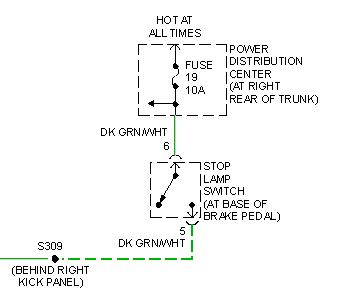

I can not get the car out of park have tried rocking it and other things but it is locked in park.
Jul 12, 2010 at 12:01 PM
MHPAUTOS
  • 31,937 POSTS
Hi there, Thank you for the donation, First check that the fuse indicated & the switch are working, this is the power source for the interlock system.
