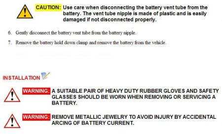

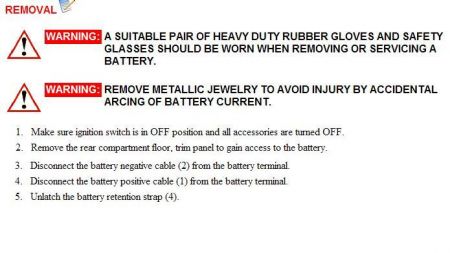

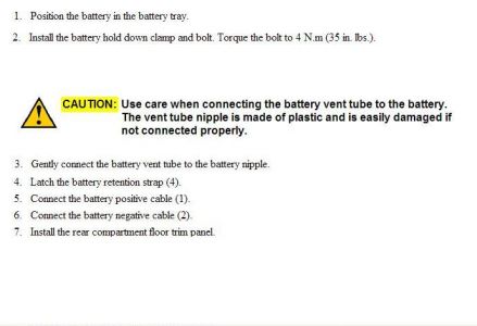

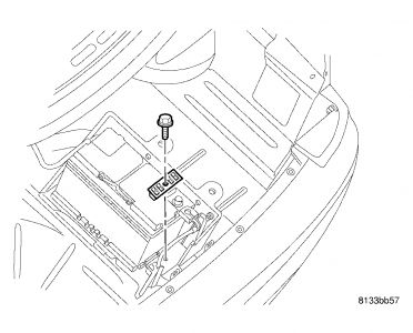

How do I remove the battery in my car? I know it is located in the trunk and have removed the battery connectors.
