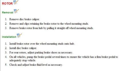

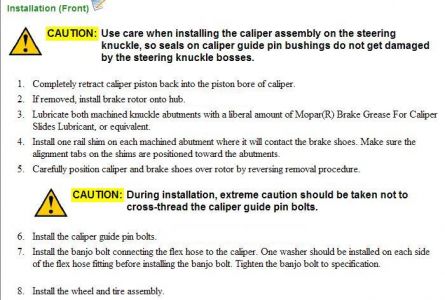

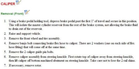

Is it a hard job to replace the rotors and brakes on this car, when driving it feels like the rotors are warped
Jan 18, 2010 at 4:33 AM
BLUELIGHTNIN6
  • 16,542 POSTS
Not sure what your level of experience is so I posted replacement steps below..
