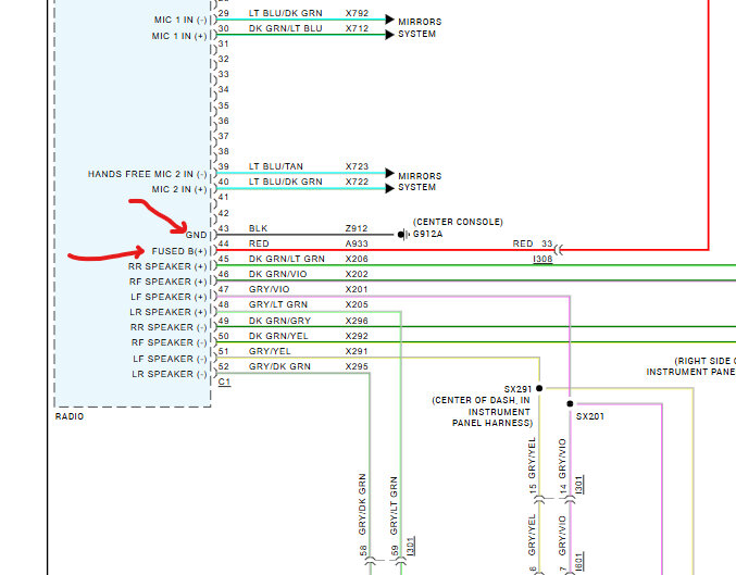

2015 Chrysler 200. Radio randomly shuts off and comes back on while driving. Car sometimes hesitates for about 1 second when accelerating from a stop (red light / stop sign). Does not stall and no warning lights.

1. Radio/Infotainment issue: the radio/screen will randomly go black and reboot while driving (music cuts out, then comes back on in about 5 to 10 seconds).

Yep, these issues do sound separate, so each issue started at different times correct? Please start new threads for the, "Exterior lighting issue" and the "Driveability symptom" Because we only handle one problem per thread. We will handle the radio screen issue on this thread, first lets look at the 3 fuses that run the system, with the key on wiggle the fuses to see if the radio blinks on and off indicating a lose connection. All three fuses are located in the fuse panel under the hood # 98, #80, and #77 have a helper watch the radio scree while you wiggle. please post your new question here, you must be logged in.

I wiggled all three fuses (#98, #80 and #77) with the key on and nothing happened. I also pulled each fuse one at a time with the car off and the radio still randomly reboots while driving (screen goes black for about 5–10 seconds and then comes back on and restarts the audio).
No other accessories shut off when it happens and the vehicle does not stall.
What would you recommend checking next?

You can check the ground but to me it sounds like the radio head unit w/screen itself is going bad which is common. You can try to get a used unit from ebay, I have had good luck with their parts. Here is the ground location which you can check at the radio as well, this guide can show you how.

thank you for the info. I was actually planning to go with an aftermarket radio anyway. I mainly wanted to confirm if it would carry over to a new aftermarket head unit if it’s caused by a wiring or ground problem, or does it only happen when the factory radio itself is failing? I just wanted to make sure I don’t install a new radio and still have the same problem.

I hear ya, take a look at the power and ground sources to the radio. I marked them in the image below. Let us know what you find.
