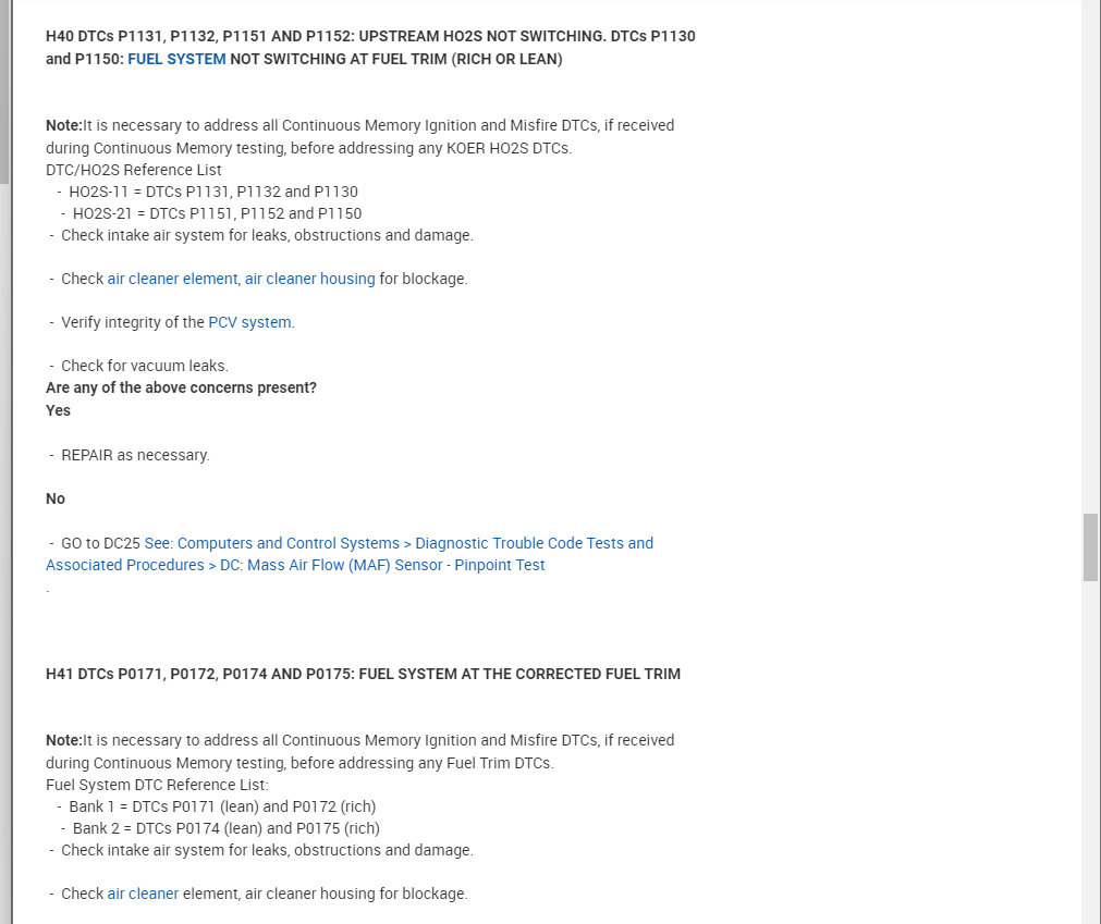

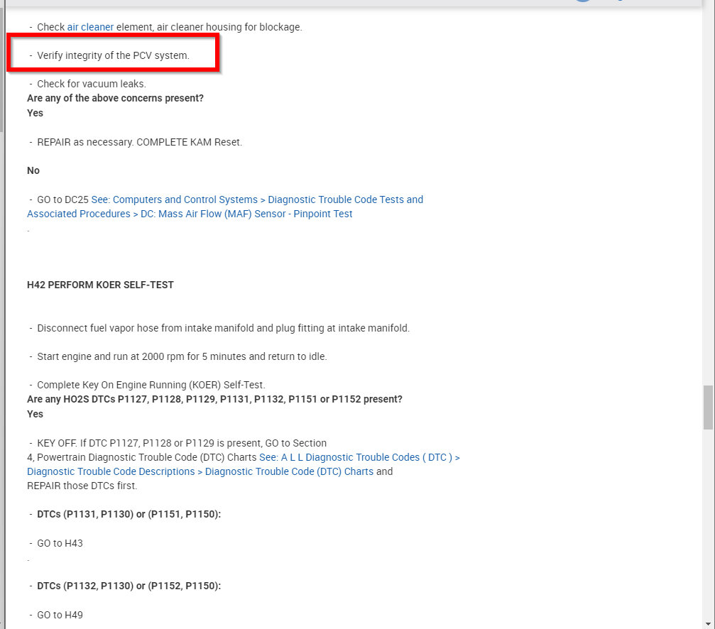

So, this issue can be caused by the PCV, so we need to make sure the valve is seated but the hose doesn't have any cracks in it.
There are a number of ways to check that but the best is to disconnect both ends, plug one of them with a bolt then put vacuum to the other end. The line should hold vacuum immediately. It is doesn't then it is cracked and needs to be replaced.
Then we need to check for vacuum leaks using this guide:
I attached the info for this code so let's run through all this and we can go from there.

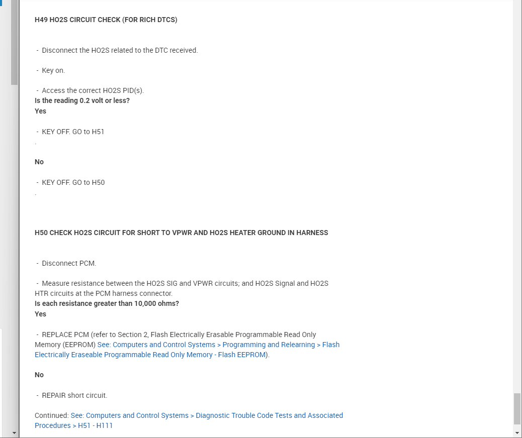

So that is odd that it is not there all the time. However, that points to a possible vacuum leak so we need to wait for it to run rough again and then spray down the intake with brake cleaner and see if it smooths out at all.
Normally a vacuum leak is more constant, but anything is possible.

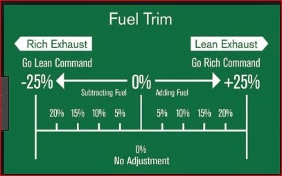

Next, we need to check the o2 sensor data when this is running rough and see if it is rich or lean. I am attaching the chart that will help with telling if it is rich or lean.
