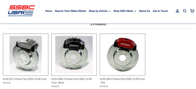

Initially looked at Nakamoto but are now out of stock. so now do not know. eLine, R1, HanSell, and others but read a lot of opposite information on line. Zinc coated or not, drilled slotted versus not, etc. I do only commute and city driving. no towing or fast driving. I would prefer a choice that lasts and has no chance of warping. Perhaps slotted is a good choice but have no idea of brand and model. See that some offer lifetime warranty others only six to twelve months. which seems to short for a rotor lifetime.

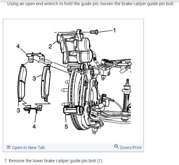

Hello, I'm Danny.

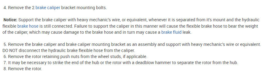

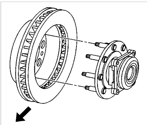

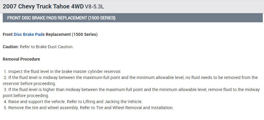

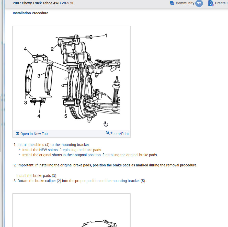

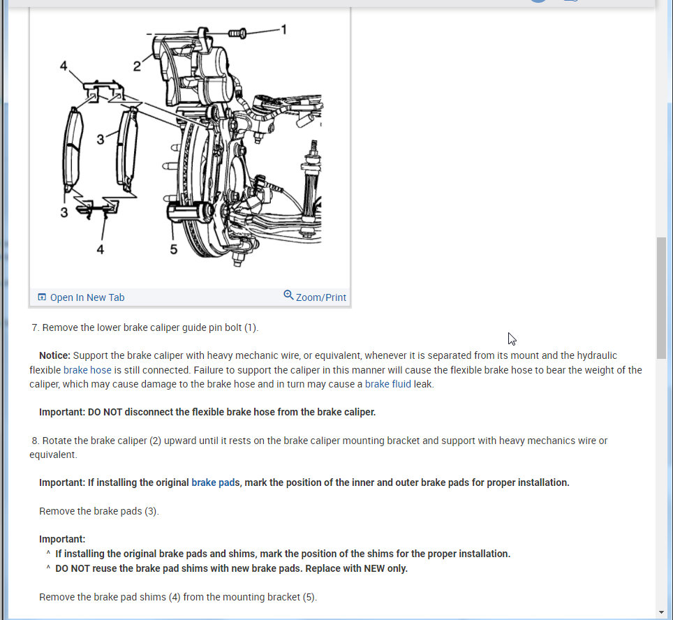

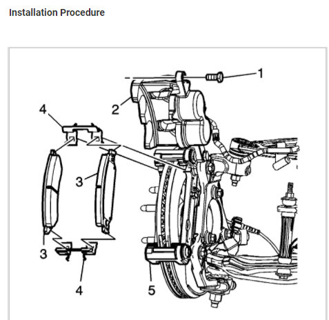

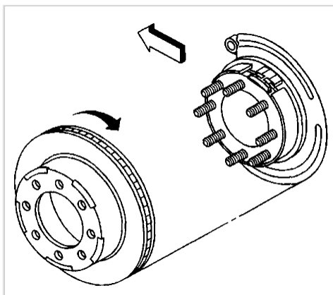

I personally have used SSBC- Stainless Steel Brake Corporation for all my high performance braking needs. They might be expensive but worth it. Feel free to contact them online or through their contact information on their website header I've provided below. Here is a tutorial for you to view on how to change front brake pads and rotors:
https://youtu.be/9pwFodKAl5A
and

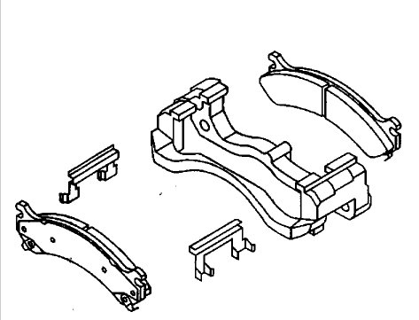

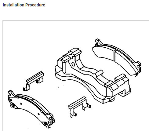

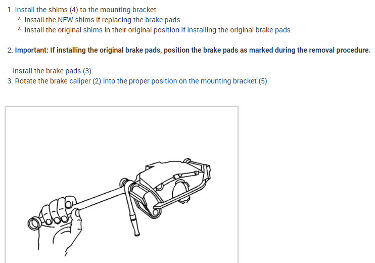

I've attached picture steps below on how to change the front brake pads and rotors on your vehicle. Hope this helps and thanks for using 2CarPros.

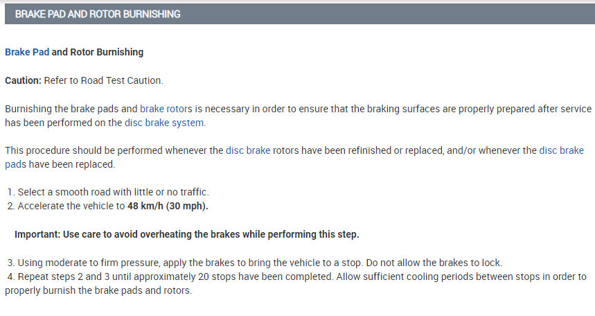

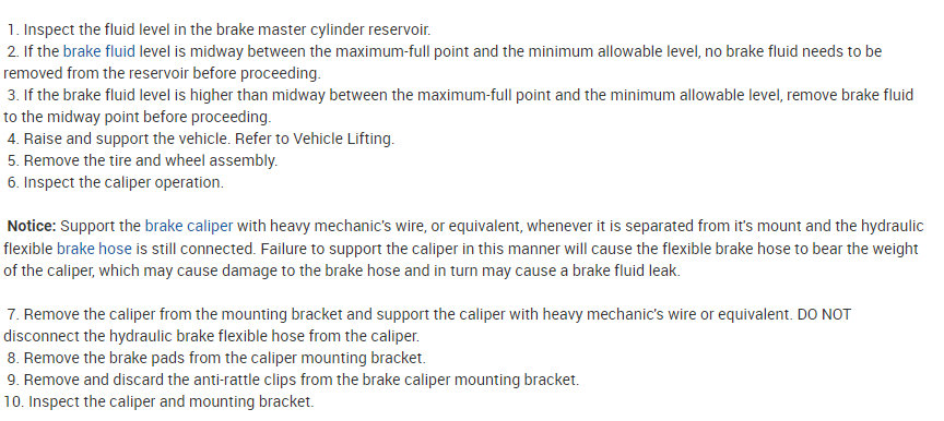

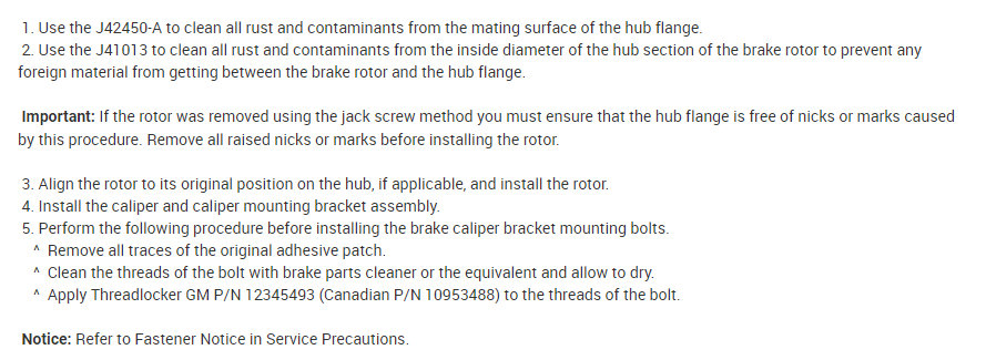

Thanks for the addition to the post.

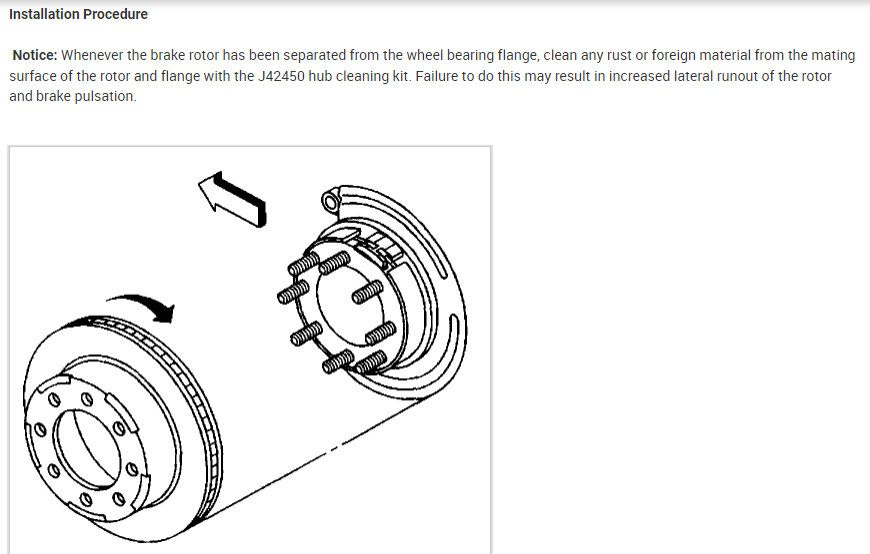

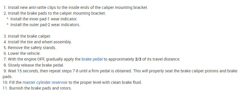

Here is a guide that will help with this:
I am attaching the process from the manual so that other will have access to it if they need this info as well.
Please let us know if there are others with questions. Thanks

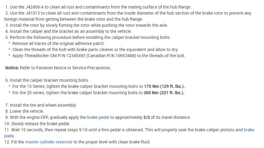

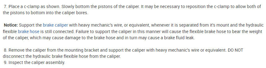

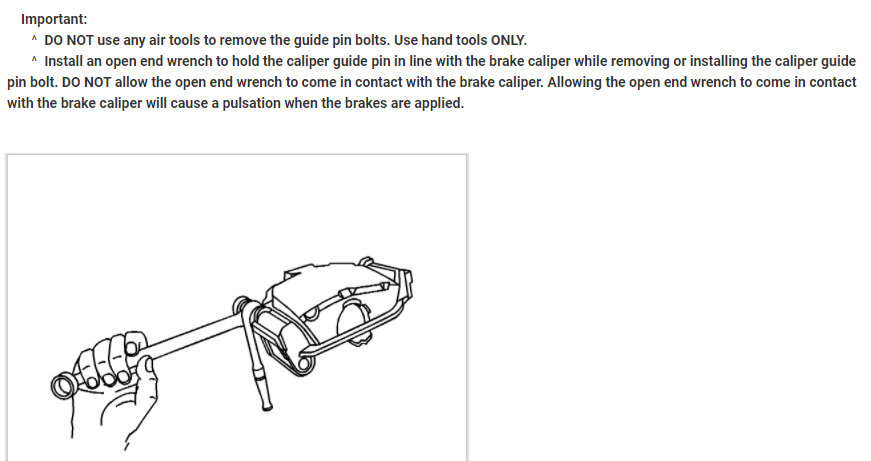

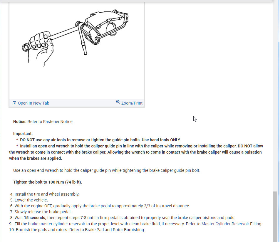

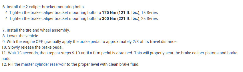

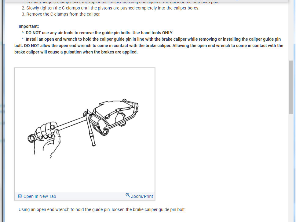

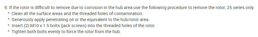

Hello, I'm Danny.

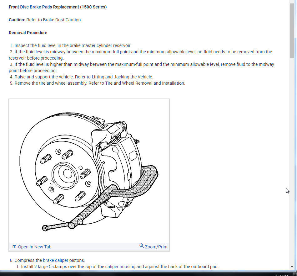

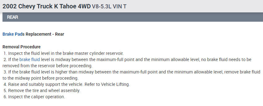

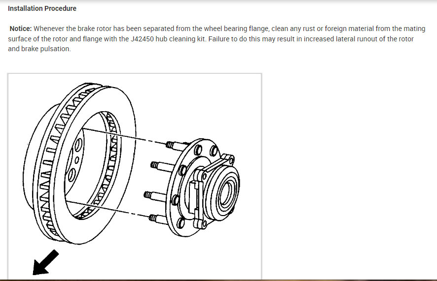

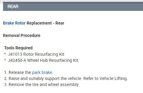

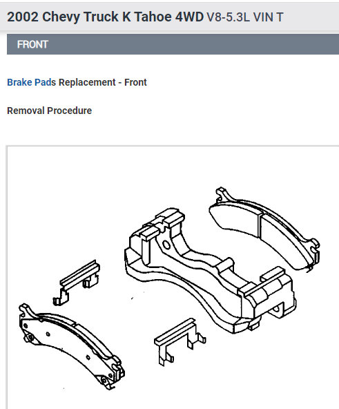

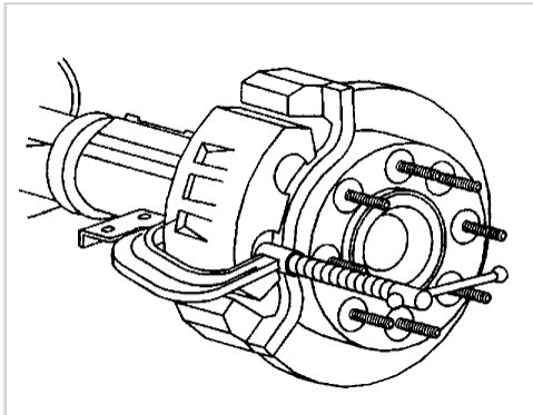

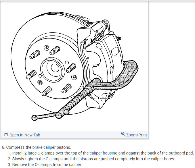

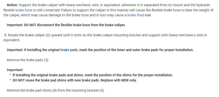

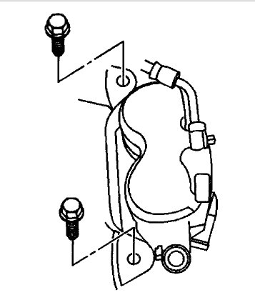

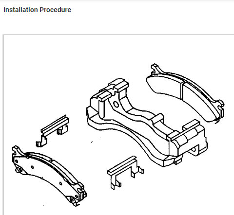

Here is the information you requested. This is a tutorial showing what is involved on how to change front and rear brake pads including the brake rotors with the special tools that are needed.
I've attached picture steps below on how to change the front brake pads and rotors on your Chevrolet Tahoe as well as the rear brakes.
https://www.2carpros.com/articles/how-to-replace-rear-brake-pads-and-rotors
Here is a YouTube video from our site on how to compress the rear caliper piston when performing a rear brake job:
https://youtu.be/j8YwfSKEzZo
I've attached picture steps below on how to replace the rear brake pads on your truck. Hope this helps and thanks for using 2CarPros.
