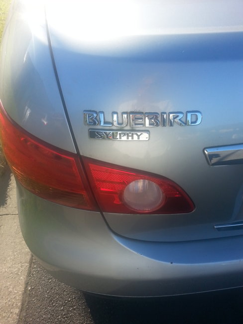

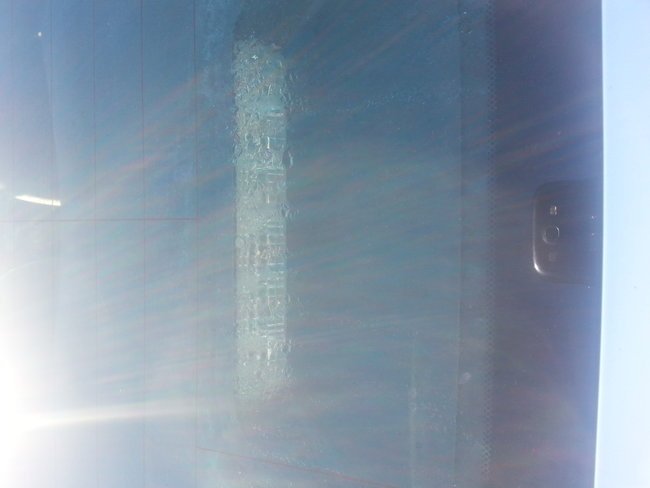

Recently I noticed third high mount brake light in my car listed above Sylphy KG11. Out of six light one is stopped working and remaining five was some time very dim and sometime shiny. I want figure out how to check this problem. This light have a excess from boot.Thanks in advance. any video or diagram is highly appreciated.

Can you send us a picture of what you are looking at?

Hi 2CARPROS KEN, I am attaching photos of stop light.
Jun 7, 2017 at 3:18 PM
  • 55,224 POSTS
It looks like you must remove the entire inside plastic panel to access the mounting bolts of the light. Dig in until you find the bolts.
Please take pictures of what you find, also do you have the camera sideways or your phone? longways?

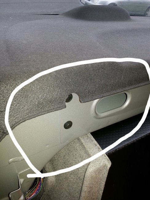

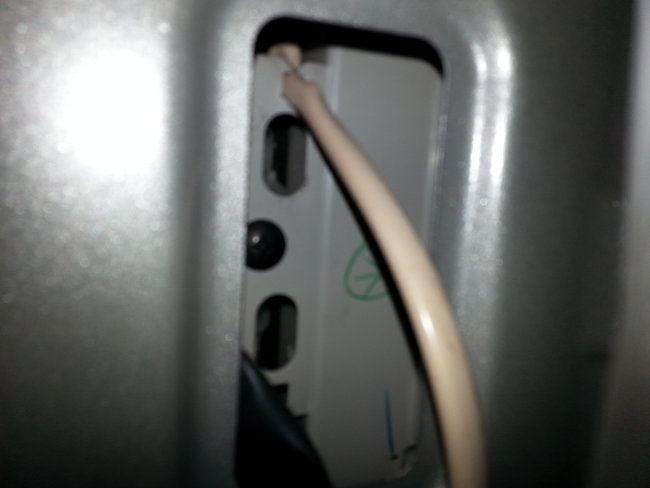

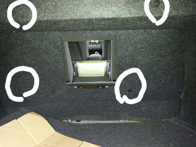

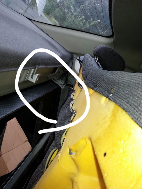

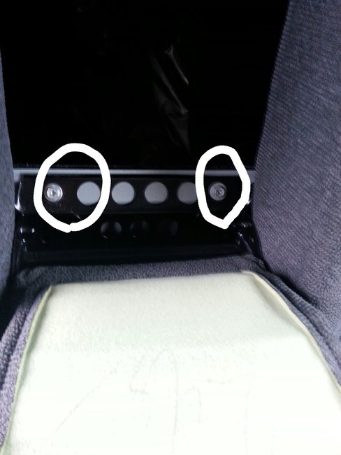

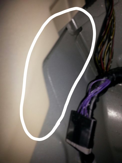

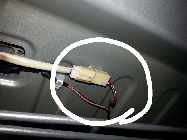

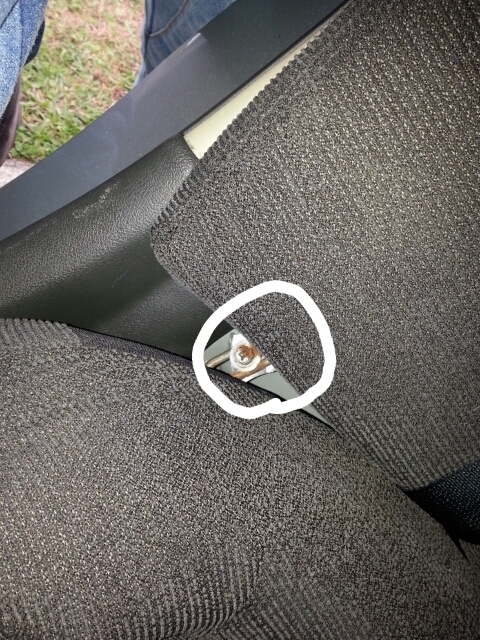

Hi All I figure out how to change my High mount stop lamp.
1) Unplug the lamp from connector (pic 7)
2) Get into cargo trunk (Boot) and remove 4 plug with the help of screw driver from wall carpet back to the seat. (pic 1)
3) Now get into the car back seat, fold down cup holder and flip the piece of carpet and you can see two bolts remove both bolts with socket wrench. (Pic 2)
4) Loosen the bolt under the seat both left and right hand side. (pic 3)
5) Lift the back seat up to remove from left, right and center hook. (pic 4) fold down the seat.
6) Remove left and right side plastic trim above parcel tray. (pic 5)
7) Now lift the parcel tray carefully and now you have a excess to High Mount Stop Lamp. (Pic 6)
Lamp is LED module so you have to change whole unit. Reverse the all step after installing new lamp.
Sorry my phone camera is not good so pictures is not that much clear.
