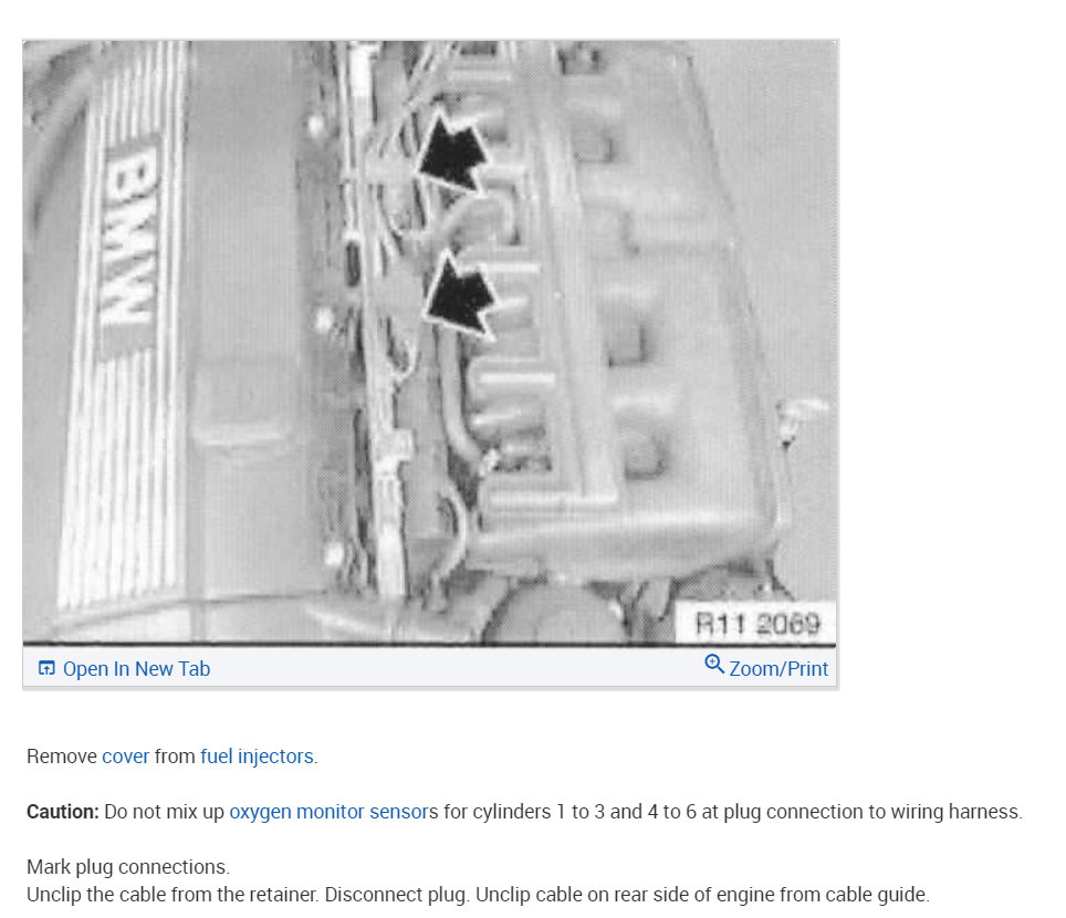

Does it seem like the noise is coming from under the car? It sounds like you have a catalytic converter that has fallen apart, jack the car up this guide can help:
Take a rubber mallet and gently strike the catalytic converter and mufflers to see if you can hear anything loose in there. If so, here is how to replace the catalytic converters in the diagrams below.
May 2, 2022 at 9:58 AM

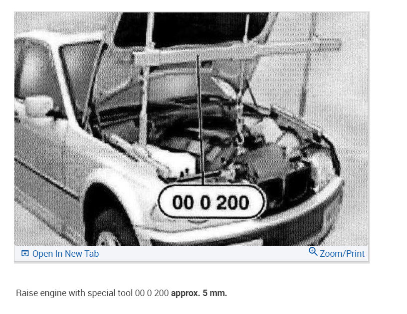

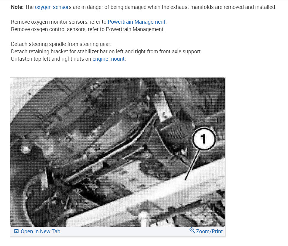

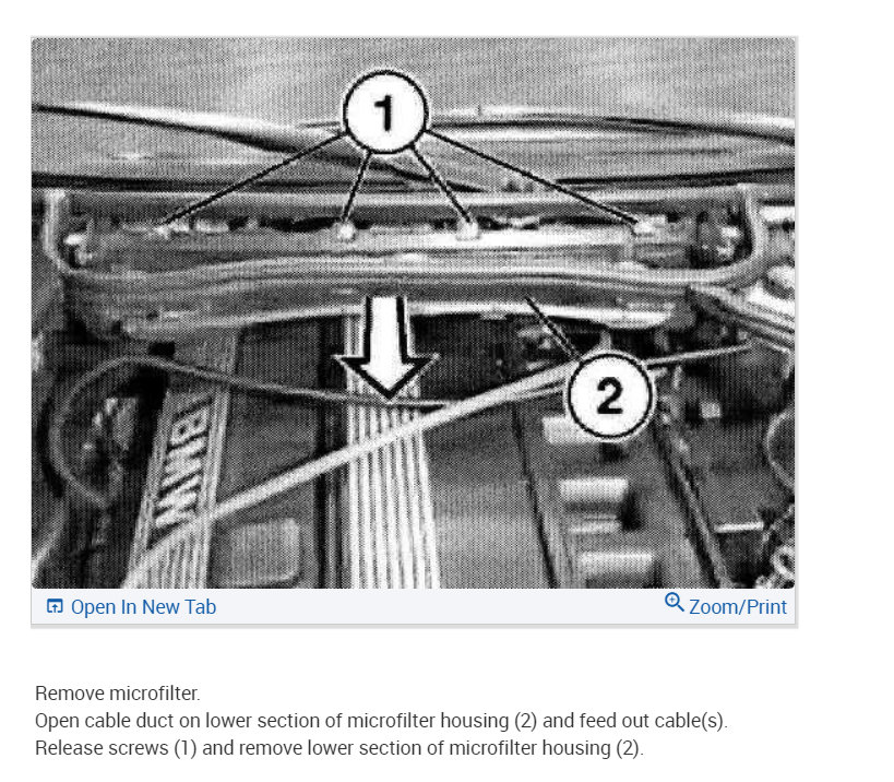

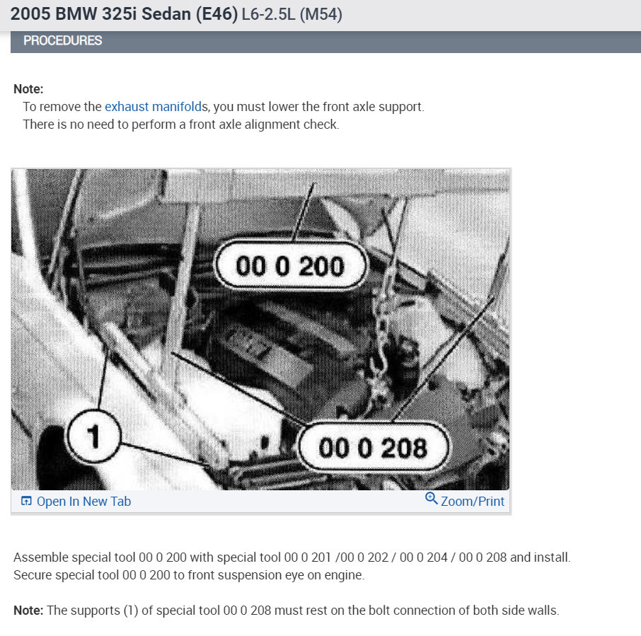

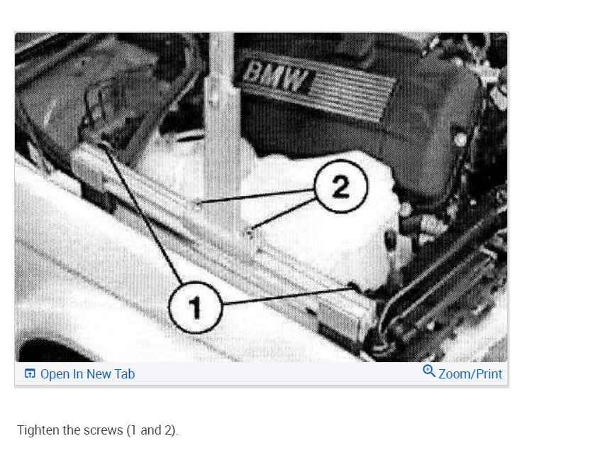

Hello, so after some investigations it seems it could indeed be a leak around the exhaust manifold. I'll have to wait a few months to get it done because I don't have any room at home and unfortunately and I can't drive right now for reasons.
I'll come back to update this thread when the problem is fixed, that could help others hopefully.
I'd like to thank the amazing team on this website for giving me clues about the problem, I'm very thankful.
