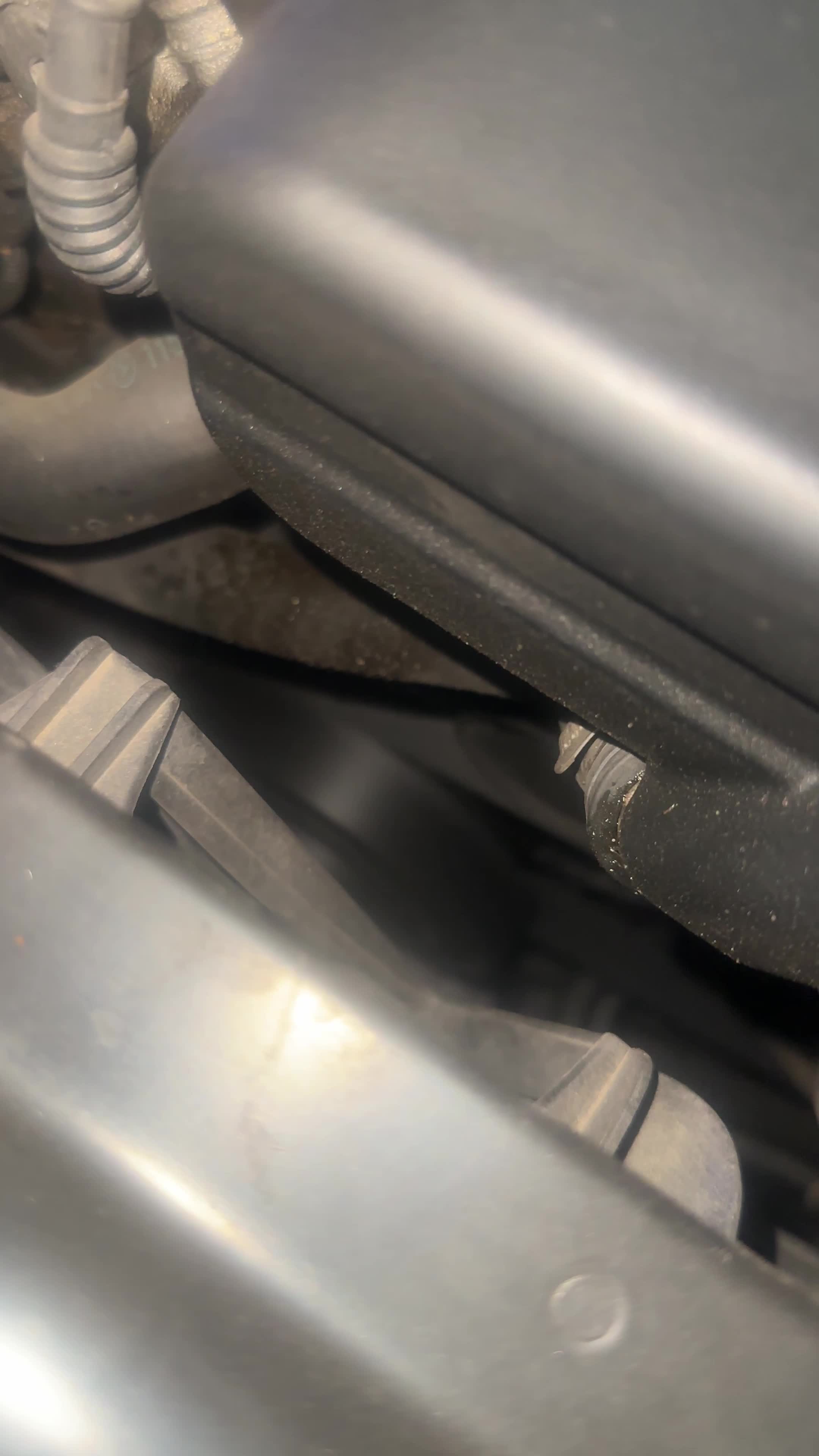

Chirping noise from I think the Serpentine Belt?
2006 BMW 530I
AUTOMATIC
DE_SPANJAARD
I’m a uni student driving across the country and while I was pulling into my hotel, I noticed a chirping sound coming from my hood. I’ve had a small oil leak that I took in to get diagnosed at an auto shop and they said it’s alright as long as I keep track of the oil level and add oil when it’s low. Does anyone know what the problem might be or how serious it is?
Aug 18, 2026 at 10:43 PM
  • 55,433 POSTS
Humm, that does not sound like a serpentine belt noise, I would remove the belt and spin the pulleys to see which one is making the noise. Also, while the belt is off, start the engine for a second to see if the noise is gone, it might be internal. Let me know.
Aug 19, 2026 at 7:36 AM
USEDAUTOPARTS PRO
It sounds like the chirping could be a belt or pulley issue, especially if it happens when the engine is running. Since you already have an oil leak being monitored, it’s best not to ignore new noises.
Sep 9, 2026 at 9:49 PM
  • 55,433 POSTS
Have you tried to remove the belt and start the engine?
