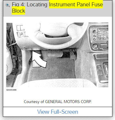

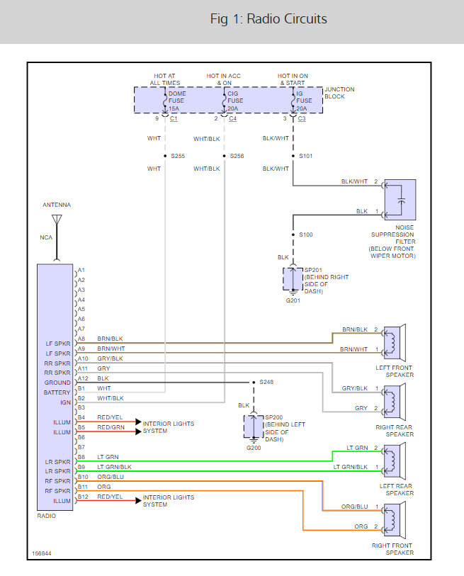

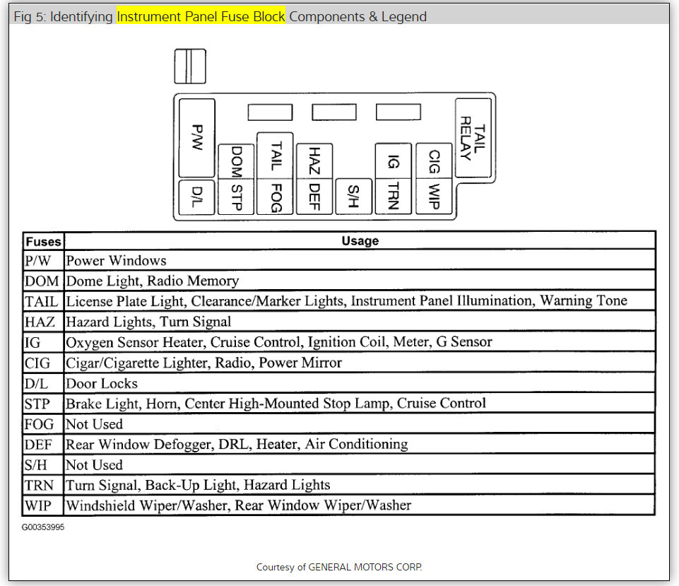

Everything worked fine and I could hear the music until I went to install the back up camera. The speakers made a pop sound and now do not work.
Sep 24, 2018 at 10:28 PM
  • 55,694 POSTS
It sounds like you have blown a fuse. Here is the radio wiring diagrams so you can see how it works and a guide to help you check the fuses ( IG, CIG and dome) with the fuse locations below:
