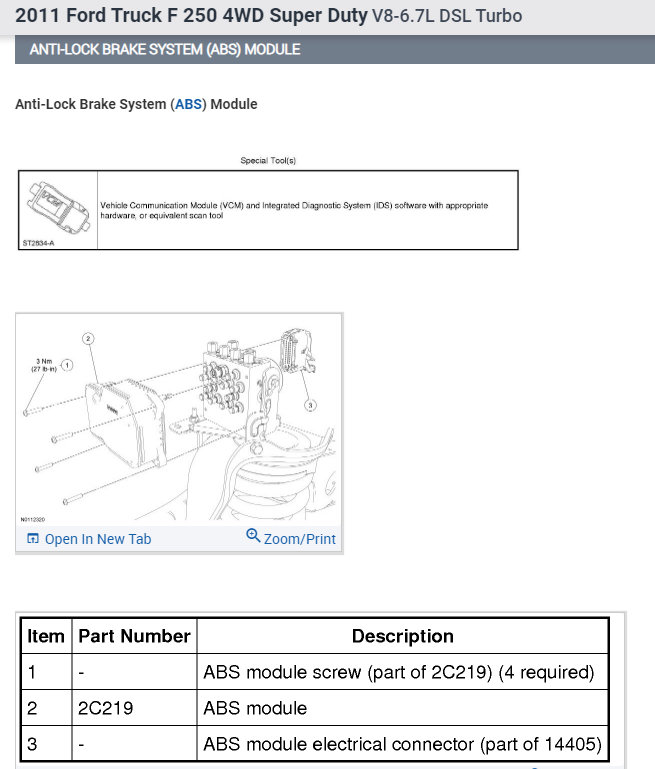

The ABS module is out, and the chimes go off continuously, is there any way to stop the chimes?
2011 FORD F-250
192,000 MILES • TURBO • 4WD • AUTOMATIC
CORY WINDERS
It will cost about $1,500.00 for the new part. Until I can save up the money for the part and get it installed, is there a way to stop the continuous chiming?
Jun 17, 2022 at 5:51 AM
SQM
  • 6,383 POSTS

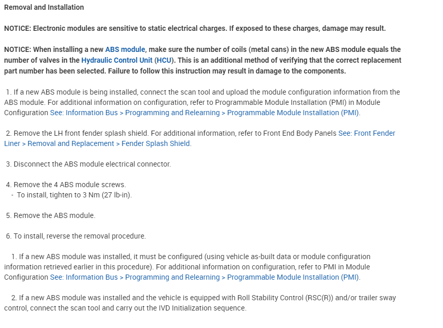

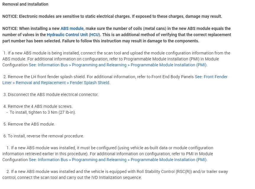

The chime gets triggered by the body control module and due to the safety aspect of the chime factory does not provide information on how to disable it. It is more of a programming of the module that controls the chime frequency and duration or when to trigger.
Let me know of any questions.
https://www.2carpros.com/articles/how-to-replace-a-abs-controller
