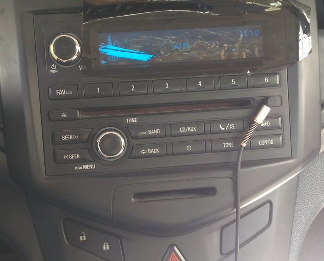

i have this radio/mp3 player in my car listed above LS model.
the car radio display has blue screen. unfortunately the screen protector or sticker is coming off due to hot weather where i stay.
i have only option is to replace the radio with a used one. but once i fit a used radio of another Sonic vehicle it gives message that it's locked.
i am also thinking if i can remove the whole sticker and fix anything similar. (please see the pic) if you see on the left the black coating already came off and i am not able to see any icon of text.

What I'm looking at is what appears to be something that was added to the radio. From the factory, they come with a think protective covering that is to be removed before delivery. It's just to help prevent scratching.
When looking at the picture, it appears to be something that was stuck on for some reason. Is it something you installed?

It's is just a piece of car tint to reduce the brightness of that blue light.. but i have put it on the body and did not stick it on the screen. FYI .. it has nothing to so with the original car stereo display. There is gap between the display and the tint piece.

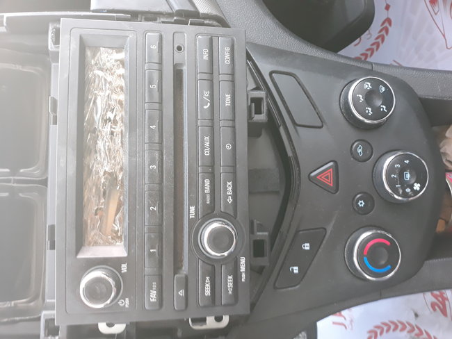

Dear Joe, for your reference:

Wow, now I see what you mean. The idea that you have a replacement that is in the locked mode indicates you have to reprogram the control module. The one you have (I don't believe) can be repaired.
To reprogram, it requires a scan tool. Here are the directions:
____________________
Replace and Program Control Module or Reprogram Control Module
To program a replacement or an existing control module, perform the following procedure:
Access the Service Programming System (SPS) and follow the on-screen instructions.
On the SPS Supported Controllers screen, select A11 Radio – Programming and follow the on-screen instructions.
At the end of programming, choose the “Clear All DTCs” function on the SPS screen.
___________________
Let me know if that helps.
