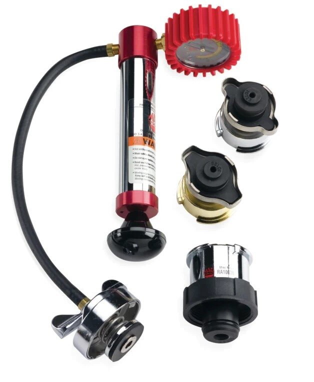

It sounds like a bad gasket. You could try one of these tests to verify the problem. That engine is normally very reliable, but they can still fail.
You can get the test gear as loaner tools. The fastest one is to use the cooling system pressure tester in a backwards way. Start with a cold engine, put the pressure tester on the radiator. Now start the engine and watch the gauge. If it starts to rise rapidly without the temperature gauge showing much of a rise the pressure is coming from somewhere and a bad head gasket would be a likely bet. I would start with the pressure test and then work from there.

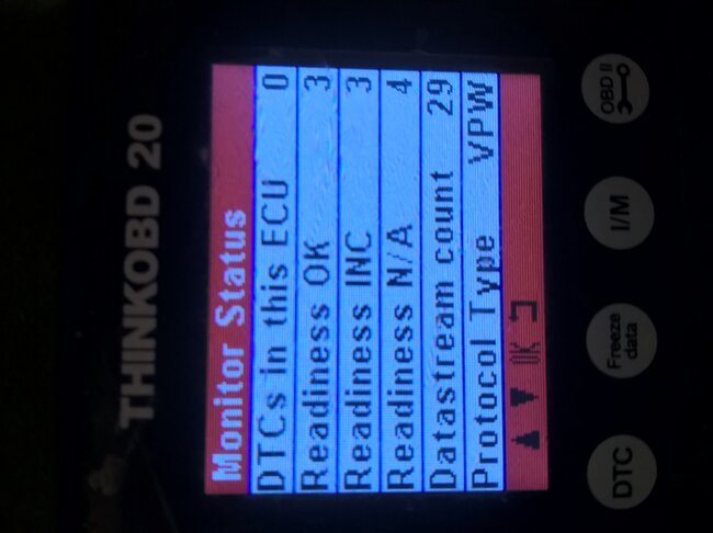

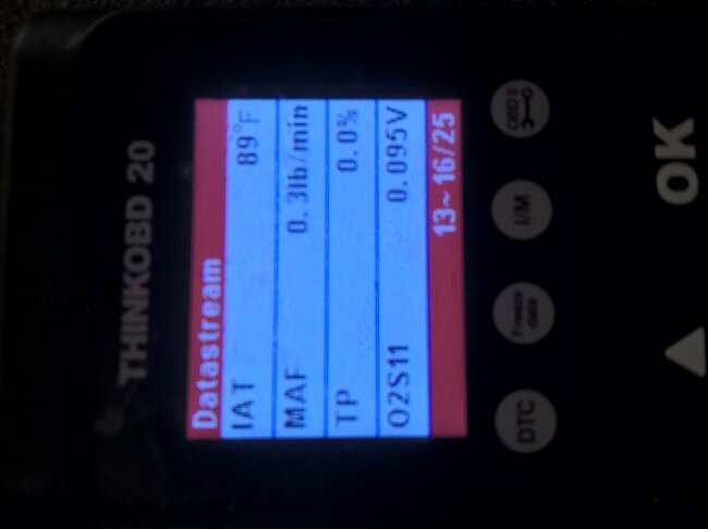

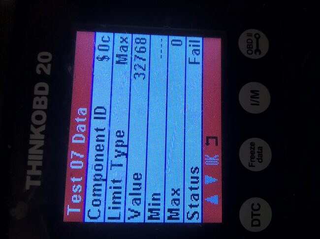

Okay, I understand, I should have mentioned I can hear vacuum like sounds like air is being sucked in from somewhere, for what it's worth it has cruise control. I checked for voltage on the ECM fuse and I'm getting 12 volts I think I was able to run a OBD2 scan, I took some photos of the results and will upload them as I can, although one does say fail the component ID $0c indicates a misfire but that is all the info I could find for that. I jumped the gun and yesterday I added some Bar's Leaks High Mileage Engine Repair. I hope it's not too late and the head gasket doesn't have to be replaced I know it can be a somewhat labored job and I'm not about to tow the rig to the shop while we are living in it, I .might have a mobile mechanic that might be able to do it, either way I need to do something before the threat of storms is on us. Thanks

Yeah, that can be an issue if you are living in the rig, and it breaks down. Vacuum leaks that you can hear could cause it to run hot but that wouldn't show bubbles in the system. A bad head gasket can cause a misfire, if that one has a doghouse you can pull you could remove that then use some starter spray around the engine to find the leak(s). You could also pull the plugs and compare them, if a gasket is leaking into the engine the plug will be much different than the ones that are not burning coolant. If you find that it is a gasket, and the rest of the coach is in good shape you might consider putting a crate engine into it. A bit more money but you would get a new engine with a warranty. instead of just a patch on the current one. That would be your choice though.

The weird thing is I never see the gauge showing overheating, maybe the gauge is stuck or something. Yes I'm about to take the dog house of and see if I can get the plugs off so far I haven't been able to get a plug wire off through the wheel weld, I would expect to find them oily, coolant shouldn't be too hard to distinguish, we aren't planning on doing much traveling in it so a patch up is our most economical option. Are you saying spraying starter fluid with ether around the engine to detect leaks? Any thoughts on the OBD scan?

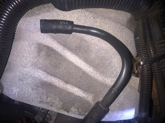

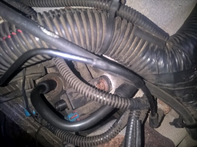

Surprising update, I had the dog house open, I was looking to take off the plug wire which seems a task in itself, when I dropped a wrench on the ground, below the driver's side lay a short hose as you can see in the first picture, I almost blew it off, but something told me to pick it up and see if it goes to the engine, sure enough, it was missing I put it on as you can see in the second picture I put it back thinking to myself it can't be that simple, in the hopes that it would change something, said a short prayer and fired it up and sure enough no more high idle to stall, smooth as butter it's obviously a vacuum hose, that had been disconnected and I probably just knocked it on the floor today, I don't know why it got disconnected and  I'm still going to have to figure out what the smoke from the manifold is about but at least I don't have that vacuum issue to figure out.

Yeah. That hose looks cooked, that's why it fell off, the easy solution is to take the rubber section off the line you have and get a chunk of vacuum line of the same size. Now just cut a piece off the same length as the piece on it and replace both ends. I would look at the other lines as well, the hoses get heated and start to break down and leak. I would probably suggest replacing all the lines simply due to age based on the way that line looks, keep other problems away for now. Then run it and see if it stays cool.

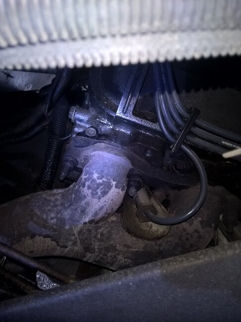

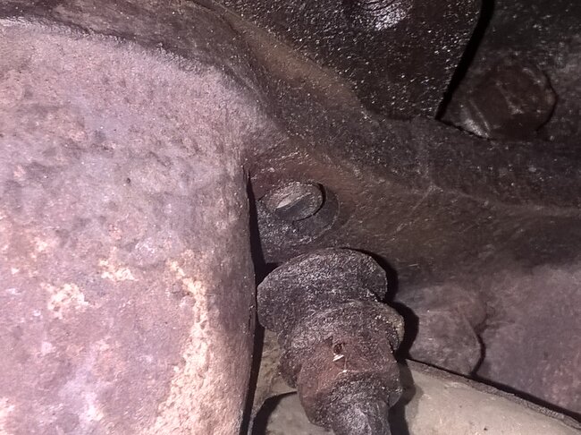

Got some good news and bad news, bad news first I broke a bolt, good news one of the bolts to the manifold was loose, as you can see in the picture it's the one on the left, unfortunately, the bolt that broke may be related to the manifold or it's just to hold the plug wire in place as there is a bolt on each fitting that goes around the wire. I'm already thinking about extraction, not the easiest spot to get to with a drill, or try to JB weld the head to the bolt providing there doesn't need to be much torque, but if it's related to the manifold, I would think the torque needs to be high. Any idea if it's for holding the manifold, my guess is the bolt is so rusted in it's not going anywhere.
May 7, 2023 at 3:36 AM
STEVE W.
  • 15,420 POSTS
Looks like an exhaust manifold bolt. Not a major issue but it could be a bear to extract without a lot of work.

First top up the coolant with the engine cold. Then follow the instructions on the kit to connect it. Now start the engine and watch the gauge. Normally the pressure in the cooling system is from the hot coolant expanding and pushing past the rad. cap at 12-15 psi. That generally takes a while because the engine has to heat up. So, if you ran the engine for say 15 minutes, I would expect the pressure gauge to get to 10-12 psi. What you are looking for is a much faster rise in pressure from combustion gases getting into the cooling system. So, you start the engine and within 2 minutes you are seeing 10 psi, that is a bad head gasket. Or if you want to check for a leak the other way, pump up the tester to whatever the cap says and wait. If you come back in 1/3 hour and it's at the same pressure you don't have any leaks from the cooling system or into the engine. However, you could still have a bad head gasket because combustion chamber pressures are much higher, and it could act as a one-way valve. Now if you run it a few minutes and you don't see any pressure then it's possible that you don't have a gasket problem, but with the oil color and residue I wouldn't count on that.
