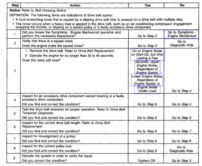

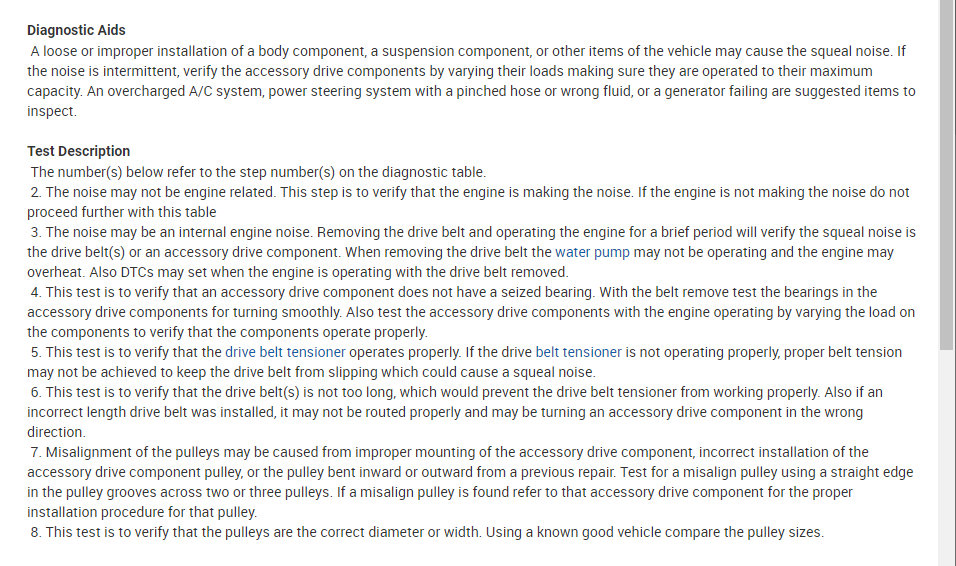

Let's start with this noise as I suspect the stall or feeling like it is going to shut off are related.
When you start the engine and the noise starts and goes away, this could be related to a belt issue so let's start by removing the belt and starting the engine.

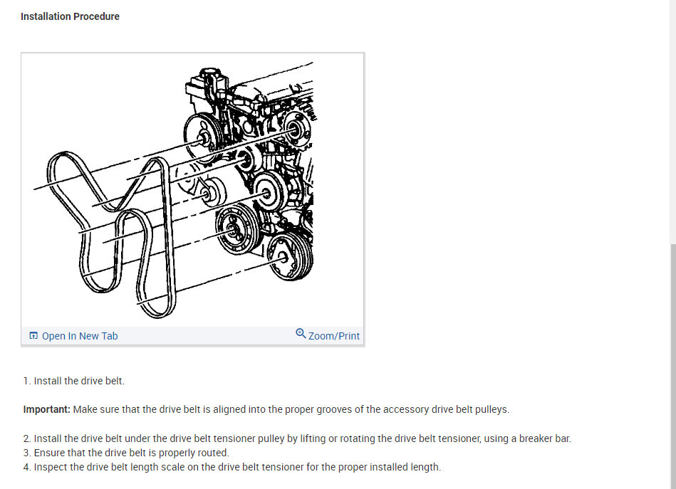

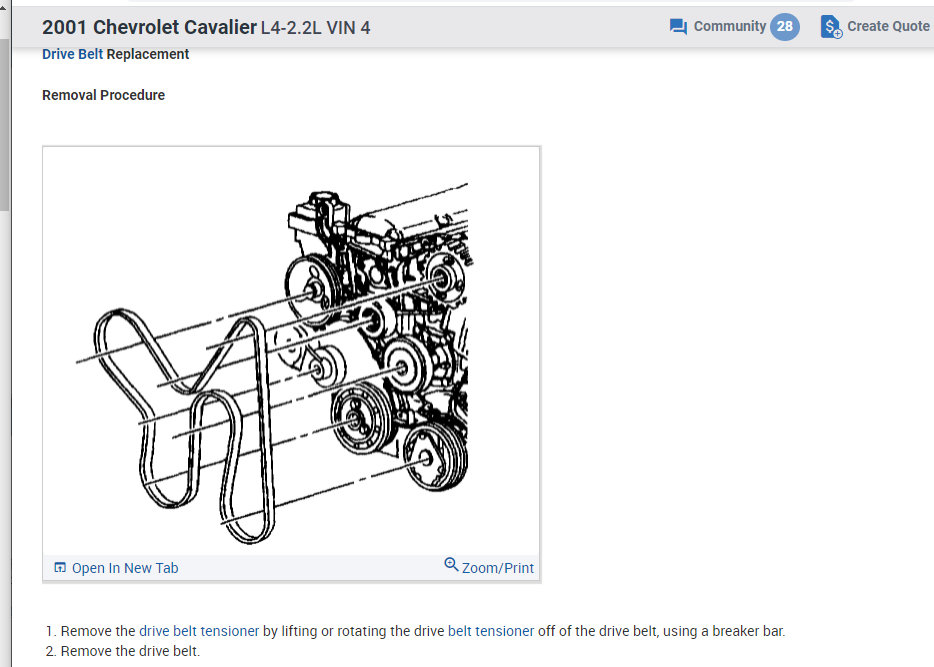

Below you will find a process from the manual that addresses belt noises and the process on replacing the manual.
Lets remove the belt and see if the noise is still there. Also, can you get a recording of the noise so that we can try and identify it?
